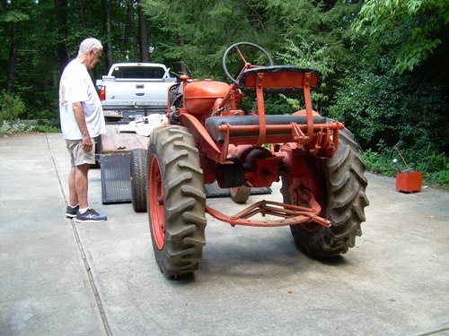

I bought another B.  This one is a 1942.  I bought it from the family that purchased the tractor new.  They bought it in Gadsden,Alabama in 1942 and used it on their Dairy farm.  It has been restored in the past, but still needs a bit of work.  It's cool to be the second owner.

Also...anyone know if that swinging draw bar is a very common option? I've never seen one.

They're not real rare I've seen right many over the years think I have 2 or 3 around here now.

Swinging hitches are not too rare but are uncommon. That one is not a  factory swinging hitch it is home made.
