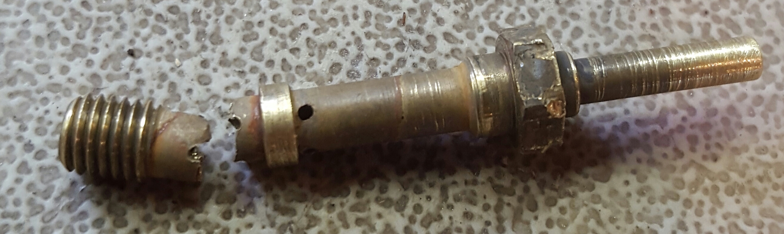

Have a 1942 allis b model with zenith 211954 carb. Anyways I took apart the front end and replaced the crank seal which went well. I decide to clean carb and the discharge jet broke on me. I've looked everywhere I can think to find it but this is unlike any jet I have found. Any help would be great as I'm down till I figure this out. Thanks for any help! I have pictures but not sure if they will post

Hope this works!! I really need some help

I figured out the number for the carb is 211954. However the nozzle looks nothing like this one.

It is Zenith. It is a 67-267 main nozzle.   Good luck.

I've looked through eBay and alot of other sources. Found bunches of the ones that are threaded below the hex but none on the other end as mine is. I'll keep hunting and thanks for pointers so far guys. Maybe I'm just missing somethin

This site (link below) has a nice carburetor use chart.  The carb you have is listed as one for a model 60 combine.  Even if you are able to fine the nozzle that you have in your carb, it will be expensive.  An option is to buy a B core carburetor and put a kit in it.  I am sure some of the forum members will have used ones for sale.
