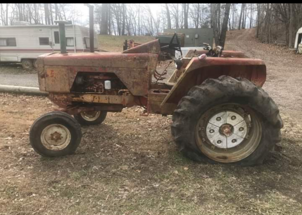

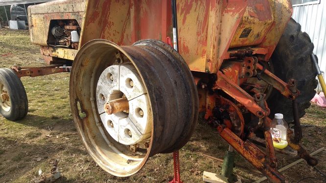

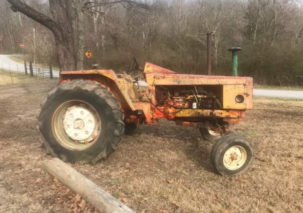

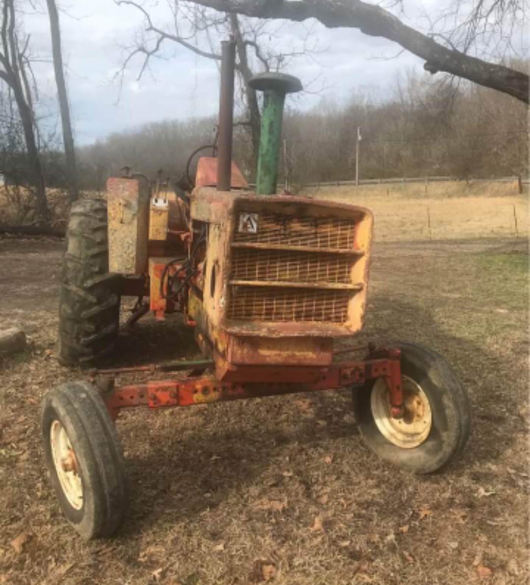

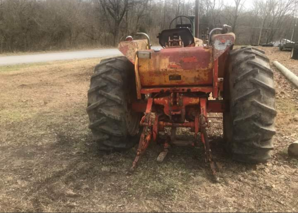

Figured out how to resize pictures on my computer. Any observations based on the pictures? My son pressure washed most of the barnacles and collected leaves from the crevices off the tractor for me. I have the tire fixed for now; I welded a patch on the rim, cleaned the inside rim to bare metal, and put a new tube in the tire. Keeping my eyes open for some good 34 inch rims. I didn't put fluid in the tire, it has some weights on it and I don't do heavy pulling so I figured that would be ok. The other rim is going to need some attention soon as the area around the valve stem has some corrosion that is eroding away the metal. I will get a picture of the "clean" tractor with the repaired tire this weekend. Calico190xt68, I bought the Zero Start block heater yesterday after reading your post. It will come Monday and hopefully get that put on the following weekend or the one after that Big smile. Dseries4, glad to hear that the manifold heater works well, if that works for you I am sure our mild Tennessee winters will be no match. I do plan on keeping it maintained for those times when the tractor may not be close to the shop.

Looks  to be in pretty good shape for a tractor that had open sky for a shed. Glad someone is giving it a new lease on life.
