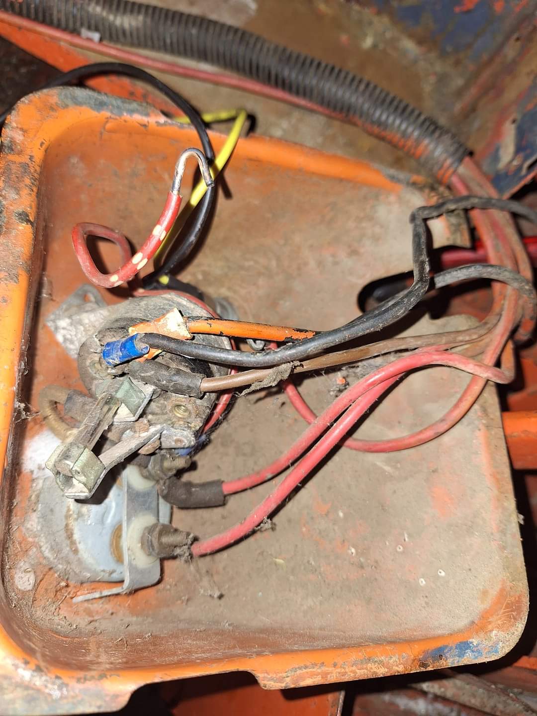

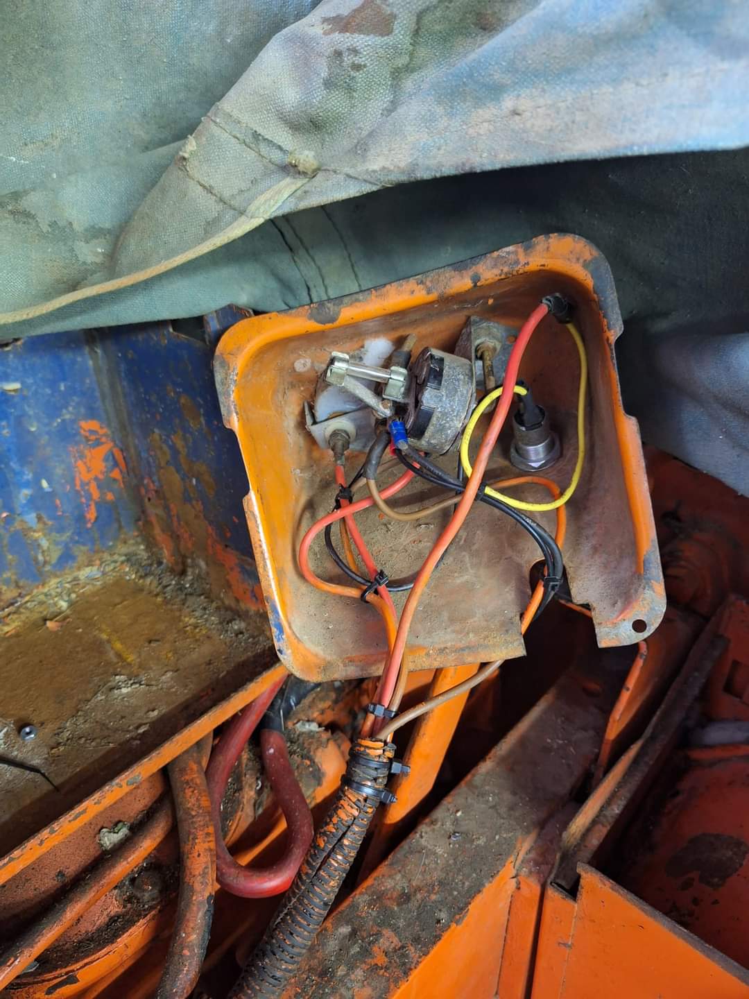

Generator tested OK so I threw it on and began taking another look at the wiring. I replaced the toggle switch with a proper key switch but I am having a tough time figuring out exactly where everything is supposed to wire up with the key switch.. forgive me as I am no genius when it comes to electrical. Something else I noticed, My 3 position switch appears to be missing the resistor all together? Looks like I may be ordering a new switch after all. Would probablyexplain the incorrect operation of the switch aswell. Right now it acts as a switch between no lights, head lights, and all lights, rather than the correct low charge, lights, high charge.

Yup, you need some new parts my friend Smile
I recommend a new ammeter as well, also take a close look at those wires with the crimp terminals.
Edit: There really is no need for a key switch unless you just want one; all it does is add complexity to a simple system.

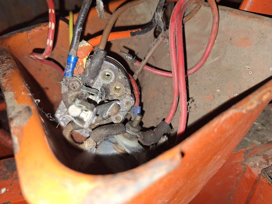

The WD45 had a Battery ignition. (Distributor)  So a key switch is needed to send power to the Coil. Simple ON/OFF is what was used as OEM.  So you did good with a new key switch. If your Tractor was changed over to a Starter solenoid, then you would need either a key crank switch, or pull power off the Ignition switch to power up a start button.
Now, looking at that 3 position switch, I can see its all wired incorrectly. Here's what should be on that switch.
Jumper wire from the Ammeter minus (-) side to the fuse tower on the H/L switch.
Headlight circuit & Tailight circuit (if equipped) to the screw terminal that has the "S" on it.  (If you look real close, you'll see letters next to the screws.) Looking at the switch, it looks like the terminal without the screw in it is the "S" terminal that should be used.
Generator Field circuit to the resistor leg on the bottom of the switch.
Should be no more than 4 wires on that switch. (3 with no Tailight or Work light)
There should be a flat resistor on the bottom of that switch. If not, you need one. This is why nothing is working correctly. I have the resistors in stock if interested. As Phil mentioned I do service/rebuild/restore and make parts for those OEM Delco switches. I'm probably the only knuckehead on the planet that does. Take all those wires off and clean up that switch. The only wire that looked correct on that switch was the jumper circuit from the Ammeter to the fuse tower.....

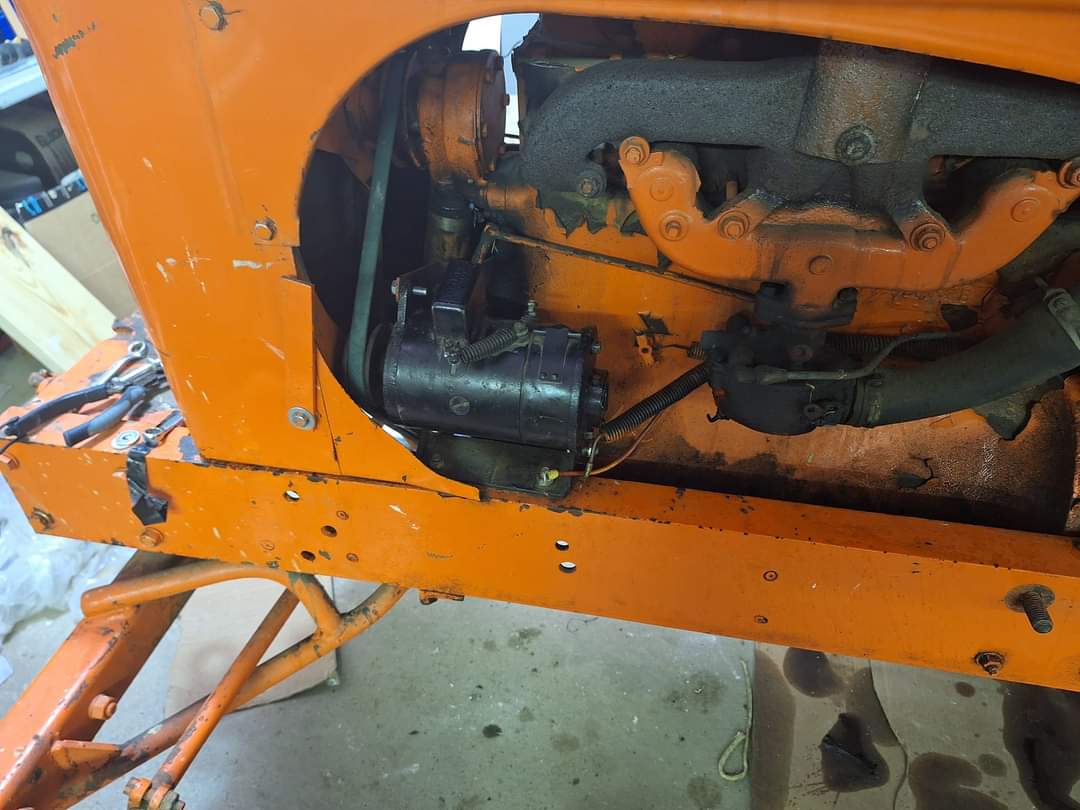

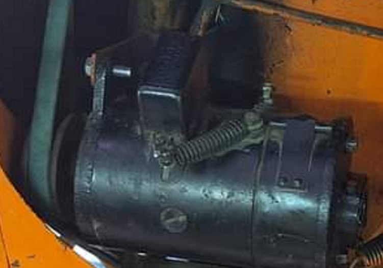

Looks like the switch resistor is installed on the generator.
Good catch! Seems as though that would leave it stuck on low charge.
Somebody really hacked that system up.

Is that a resistor or just a coil of wire ?  Looks more like a spring than a resistor..  and it is connected to the CUT OUT ??  Resistor would go to GROUND  from "F".
-------Somebody really hacked that system up.----  and didnt have a CLUE what they were doing..

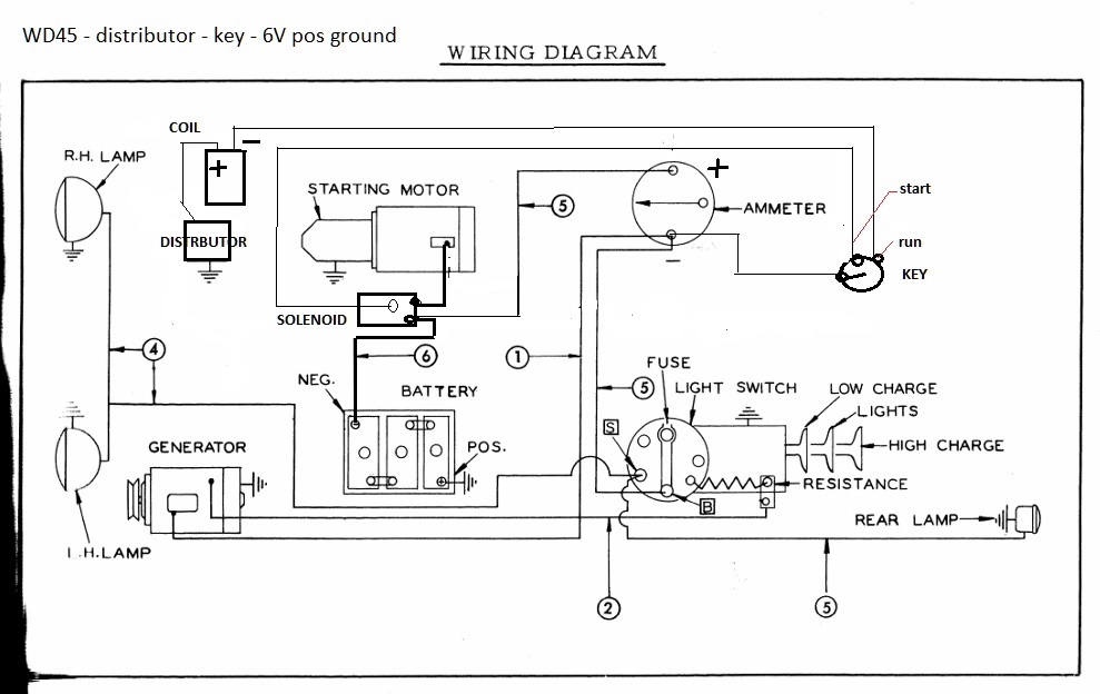

The wire diagram link on the previous page is actually for a B-C-WC type tractor as it is 6v POS ground.. but has a magneto  / kill switch / push rod starter..
I looked online and really dont see a WD45 type wire diagram. I marked up the B -C Print to show a COIL- DISTRIBUTOR - STARTER SOLENOID - Key SWITCH in addition to the original 6V POS ground system with the Resistor light switch.. I believe this to be correct.
-------<span style=": rgb254, 252, 212; color: rgb0, 0, 36;">Somebody really hacked that system up.----  and didnt have a CLUE what they were doing..</span>
</span>
</span>
</span>
That is just a wire with plastic loom around it.

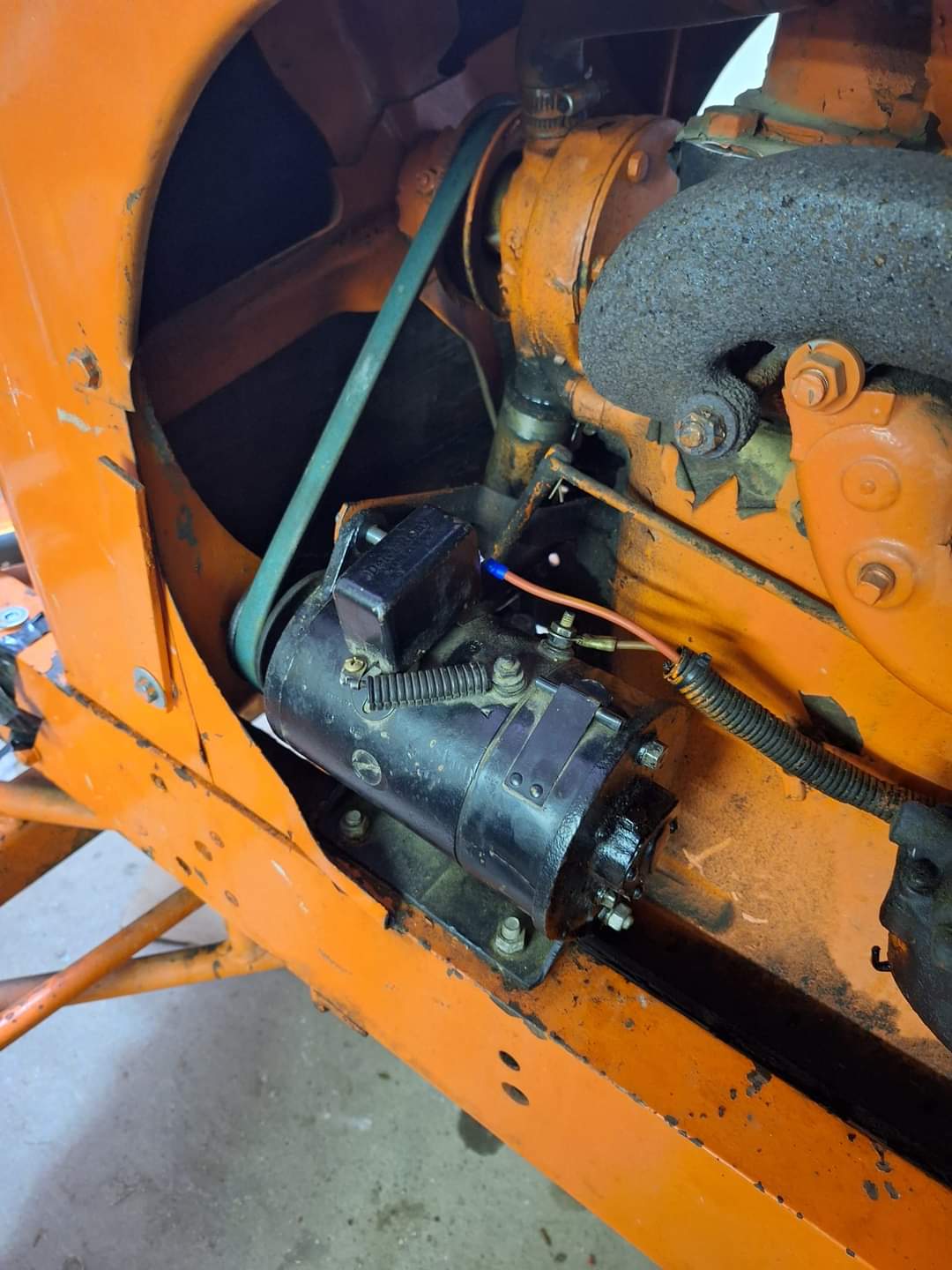

I think I've got it now. I runs great and was charging steady 4v in low charge and 7-8.5 in high charge. Lights are non functional, so I think what happened is someone moved things aroind to get the lights working and didn't take account to the functionality of the switch.
I do still need to replace the switch, but everything including the ammeter save for the lights ins functional.

Looks like your needing to ground your Generator there at the battery box. A voltage regulator for the gennie would probably be a better idea, then you won't be overcharging the battery. and won't need to worry about grounding the control panel.
  Also check your ammeter to see if it has continuity across the lugs. Have had several that failed over the years.
