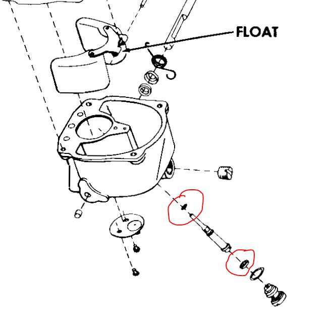

First - anyone have good instructions on rebuilding the TSV13 carb? I cannot tell where the orings go on the main jet

The O ring would be a hard flat washer that slips over the threads of the jet before it is screwed in.

Thank you both.  for the main jet, I was referring to the two items circled in the image below.  I unfortunately did not measure gap before closing it up.  the engine is bored .030 over and I ordered rings for .030 over.  The valves were all set to 18/35, though at this point I am tempted to recheck all of them.
