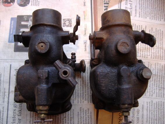

I am working on a 49 "C". I have gone thrugh the carb (zenith 9705) and even rebuilt it. There is a hole on it that I dont know what is for. I can not find any solid information online about it. The hole is on the bottom of what appers to be the througt of the carb.
Hope this help. Thank you.

That hole is a vent and should be filled with a porus material. Green Magazine just did an article about it. Maybe a freind will have a copy. I just gave mine away yesterday, but will get it back in about 2 weeks. LOL Bob

Thank you guys for the Information. What kind of porius materal is it? What can I use as a fix?
