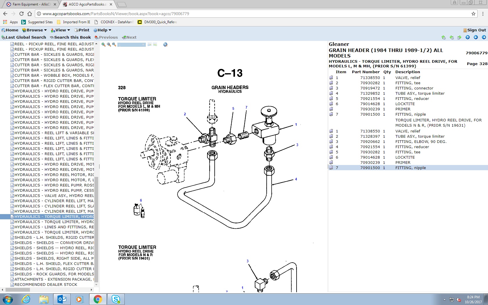

Looking for the check valve, I found this for the "torque limiter" (relief valve) which may do both functions on the reel of limiting torque and the "overrunning".  Could be like what Tbran said with a piece of junk in this, or maybe the screw backed off and lowered the relief pressure.  Would be #1 in the picture.

wayneIA I don’t have a torque limiter or a check valve that I can find. I did find out what the problem was (this could only happen to me) the weld had broken on the tube that drives the reel. It was rubbing just enough that it would turn till you tried to cut beans. Needless to say the last 2 days haven’t been very good would like to thank everyone for all ideas as I didn’t know where to start looking

You are correct, I was thinking of the later series heads which have the valve mentioned. We have had several fractures as you experienced. Reel end wrap with crop or weeds really put a strain on the drive tube.
