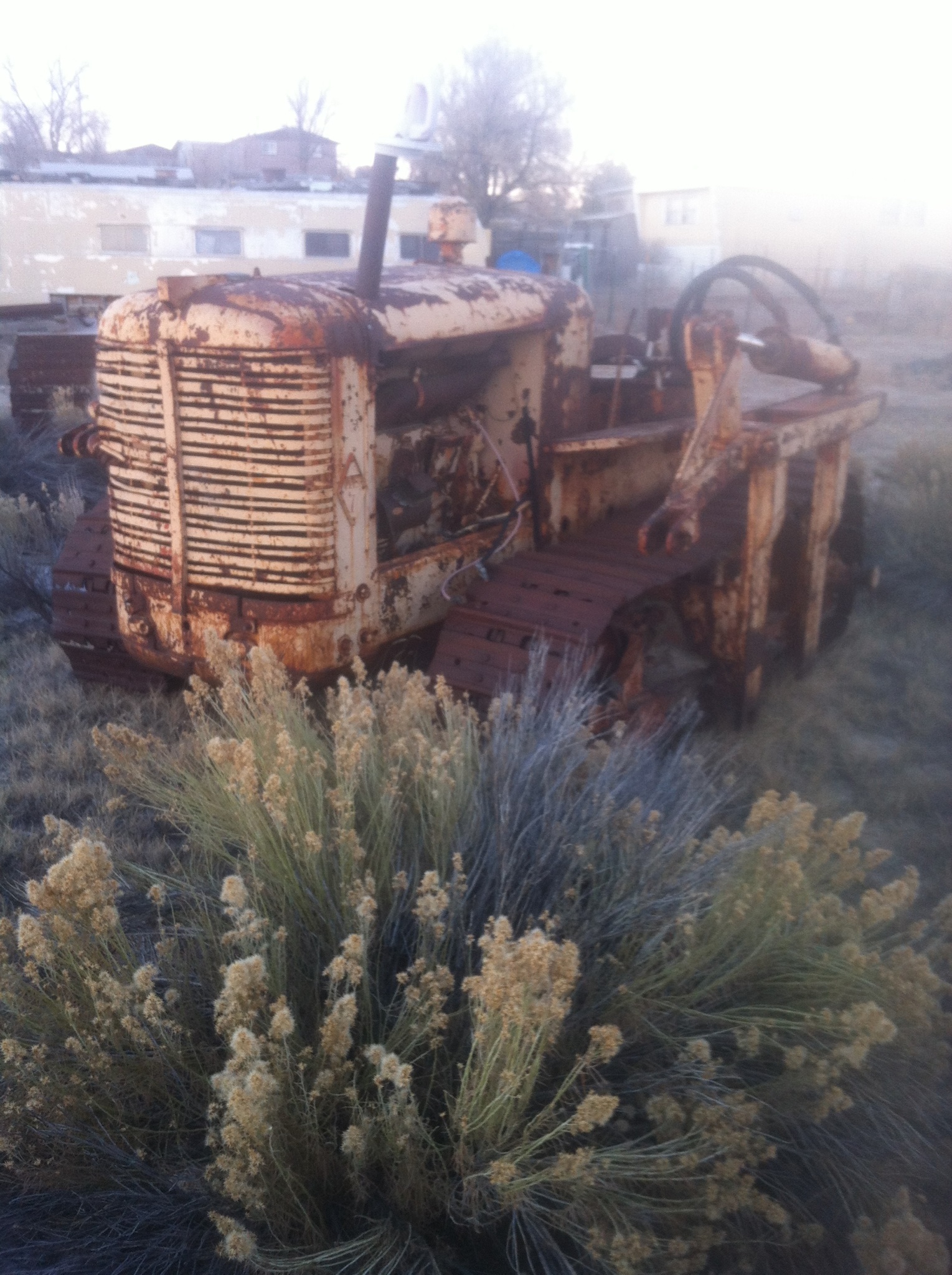

Hello everyone. Im new to the old equipment restorations. I just recieved a HD7 and im trying to find some parts to get it moving again. It runs great and the trans goes through the gears good. The old owner took the steering clutches out of it and lost some parts. Im having a hard time finding anyone with HD7 parts. I ordered the parts manual off ebay this week so I know the right terminology for each part is. Can anyone give me some insight or atleast tell me if im on a sinking ship or not. Thanks

Ok thanks Coke. Ill check in on these leeds. I have also heard of a few out in the desert around here in the old mining districts. Im planning on going exploring after huning season ends in Nevada. Dont need to get shot at lol. Im going to take some more detailed pictures so you can see what i have. It is truly a basket case right now.

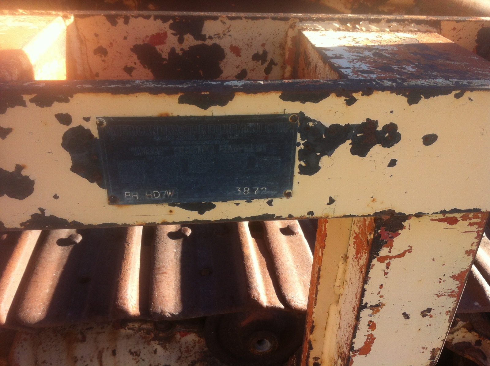

Here are the ID plates off my dozer if this helps anyone.

     Hi, Ray is right that K crawler  transmission and clutch parts could serve as replacements so your search might be broadend by searching for a K.  If you need a Factory service manual covering HD 7  10 & 14tractors & engines I have a factory one . Good clean manual. $35 00 plus shipping.

Hey guys I found a picture and parts numbers. Will these parts numbers cross over to another machine that may have the part i need? I need one bevel gear #038169

If you mean n,o 22 on the parts plate according to my parts books M crawlers are the same part n,o steering clutch bands and plates are the same to just more of them.
