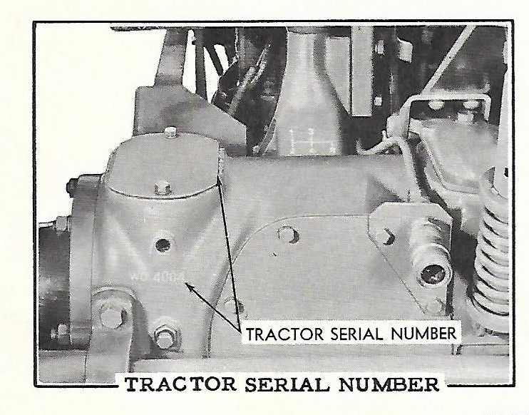

I inherited my Grandfathers Allis Chalmers WD and am looking for the Serial number. I know it is supposed to be on the top Left Brake differential, but I am still struggling to find it. Can anyone give a detailed description or have a picture of where I should look?

looking at back of tractor' to left hand side back side of brake cover' on casting' should be wd- number;

Just above the lift arm shaft on the left side very close to the setscrew with the SQUARE head on it.
Dave H (NE) View Drop Down
Location: Western NE
Points: 288
Post Options Post Options   Thanks (0) Thanks(0)   Quote Dave H (NE) Quote  Post ReplyReply Direct Link To This Post Posted: 19 Aug 2018 at 5:28pm
See picture

I should also mention I have one that is smooth with no number I guess the housing was replaced at some time.
Points: 8532
Post Options Post Options   Thanks (0) Thanks(0)   Quote Sugarmaker Quote  Post ReplyReply Direct Link To This Post Posted: 19 Aug 2018 at 7:32pm
Also to mention that I have one (1950 WD) that has had a later 1952? WD differential housing replaced. About anything can happen out there in the real world!
