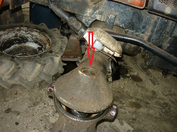

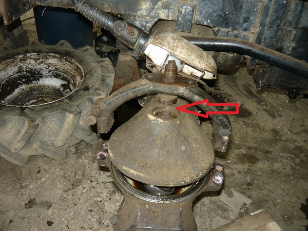

I was wondering if anybody has a different number for a top bearing for a Allis 5020 4x4, the agco number is 72098759. it goes in the top of the axle/final drive housing below were the tie rod bracket bolts to.
there wasn't a bearing at all on the right side, the left had some mangled pieces.  thanks dt.  even if somebody has the size/dimensions.  have a great day.dt

no luck at western Kentucky.  wengers in Meyerstown pa searched and found 1 place that's selling them. around $70. + shipping each, and I need both of em. ugh.  payday next week.  looks like the parts for the d14 are gonna have to wait another month...I understand parts are hard to find for a 5020, but a bearing?

did you try the site I posted? $62 plus shipping

Manufacturers number:
http://www.southern-global.com/4wd-top-bearing-set
Dimensions   SKF
http://www.skf.com/group/products/bearings-units-housings/ball-bearings/angular-contact-ball-bearings/double-row-angular-contact-ball-bearings/double-row/index.html?designation=3203%20A-2RS1TN9/MT33

I believe that's were they are ordering them from.  Thanks for all the responses.  glad tractor work is done for a little bit, bearings in the 5020 and the front grill radiator and such is tore off the d14 so I can make alternator brackets and install a hydraulic hub on the crank shaft pulley!!!  maybe I should by 3 tractors, so I can have 3 of em to fix at once....ConfusedConfused

the top bearings and seals are in and the tractor is back up and running.  I'm gonna be posting it for sale soon, so if there's any interest let me know. thanks dt
