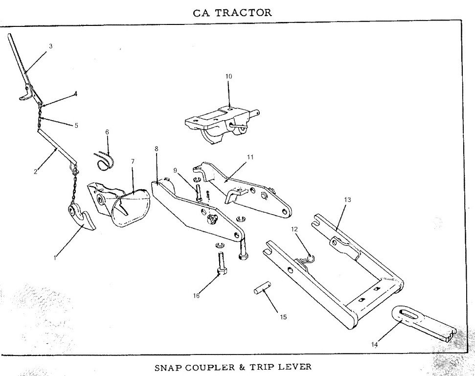

Got a fellow that is missing the hitch on a CA he just bought.  Can somebody get me a good drawing of part # 8 in the exploded diagram below?

 you  are  treading  into  the biggest  kettle  of  worms  on a CA.   There  are   2 different  sets  of  those  brackets ..   brackets  off  a  snap coupler  tractor  do not  fit  the  pin hitch  tractor.    Tony

A pin hitch tractor doesn't have those brackets. The ones from a D10/12 will also fit a CA, however the CA ones won't work on a D10/12.
