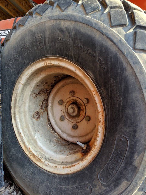

I am badly in need of a set of Allis 5020 Rear rims, mine are rusted out and leaking fluid. I cannot seem to find any, also have looked at Simplicity 9523. Do I have any other options on what will fit?

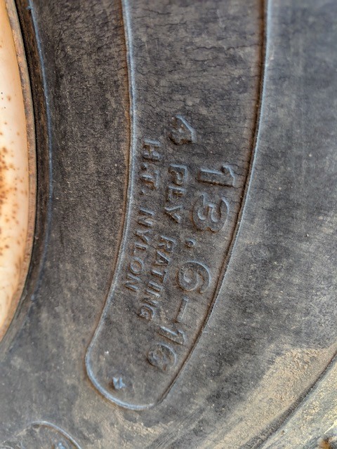

Post Options Post Options   Thanks (0) Thanks(0)   Quote mnsledboy Quote  Post ReplyReply Direct Link To This Post Posted: 19 May 2022 at 1:50pm
I have the turf rims. Here are the pictures of them. I dont know the exact bolt pattern but this is a 1984 2WD

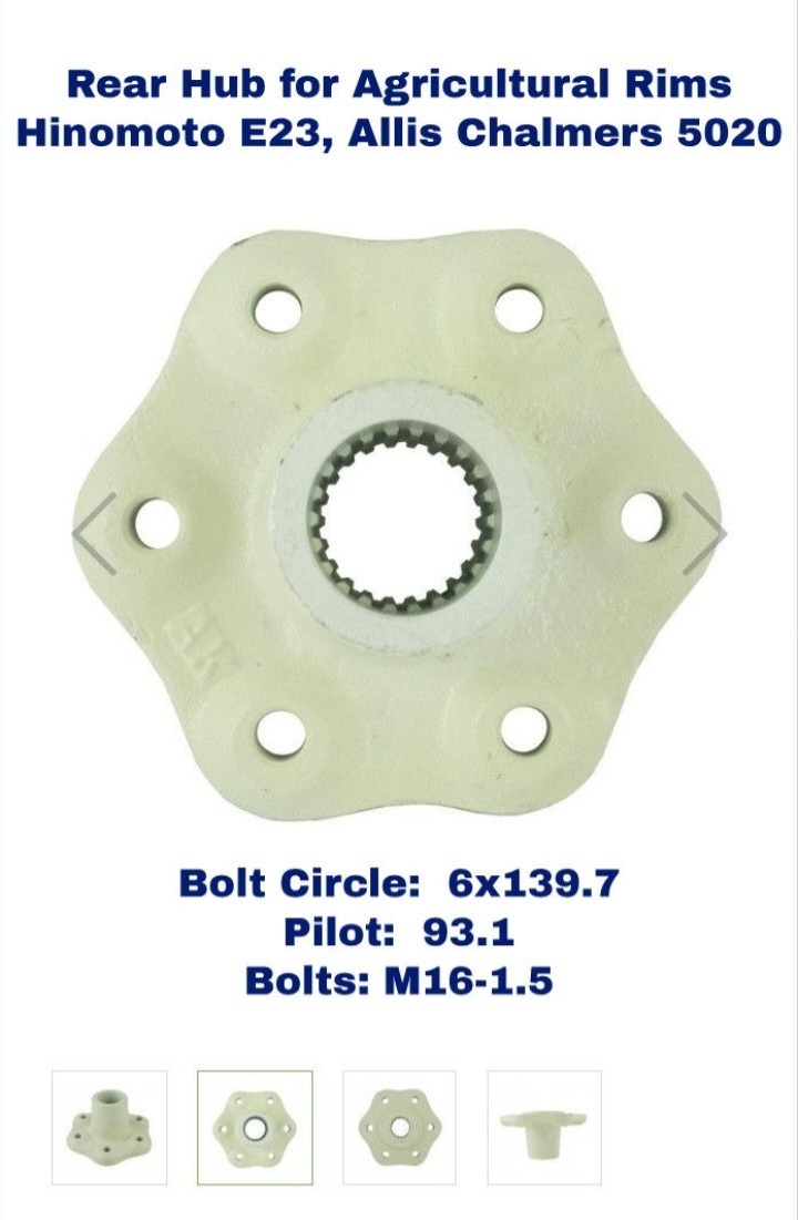

Post Options Post Options   Thanks (0) Thanks(0)   Quote Pferdestärke23 Quote  Post ReplyReply Direct Link To This Post Posted: 24 Jan 2025 at 8:45pm
This is the
Hinomoto E23 Rear AGRICULTURAL Hub
used for the Allis Chalmers 5020.
B.C.    6x139.7
Pilot   93.1
Bolts   M16x1.5
Hinomoto used a
completely different Hub
to mount the TURF Rims.
[ This Hub is available NEW in Europe. But not any Rims. Go Figure . . . ]
Edited by Pferdestärke23 - 24 Jan 2025 at 9:03pm

Post Options Post Options   Thanks (0) Thanks(0)   Quote Pferdestärke23 Quote  Post ReplyReply Direct Link To This Post Posted: 24 Jan 2025 at 9:35pm
Hinomoto made both
a Rear AG Hub
and
a Rear TURF Hub
for these tractors:
     Hinomoto E23
     Allis Chalmers 5020
     Simplicity 9520
     Massey Ferguson 210-4
     Hinomoto E25
Presumably the same Hubs were used for the
      Deutz-Allis 5220
Later on Hinomoto was purchased by Hitachi so
presumably the same Hubs were used for the
      Hitachi NZ235
It's such a shame that Hitachi eventually
stopped playing with its new toy . . .
Edited by Pferdestärke23 - 24 Jan 2025 at 9:48pm
