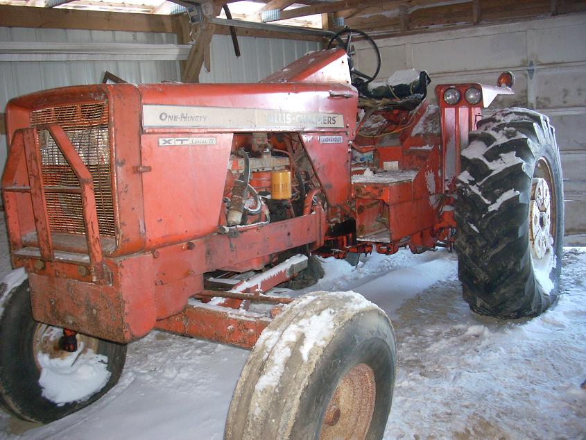

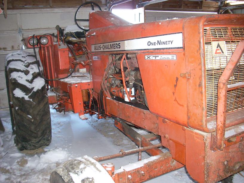

OK guys here she is, a 1970 Series III. It was parked in this garage in 95 when he sold the farm! The fuel is definately gumbo! Gent said the transmission never jumped out of gear.

looks like it snowed inside the garage as much as it did outside!! lol

That's not a bad lookin' tractor, Cap'n!  Looks like you need to take it to a good home for some TLC!!

one thing of concern for me would be water in the exhaust. The turbo and elbow are probably rusted away to nothing, but if your lucky thats as far as it went, but it likely went down into some cylinders. It does crank over though, so that is a good sign.

Yeah we've had 60 mph winds the past 2 days and the snow filtered into the shed through 2 busted overhead door panels. The stack was cut off below the hood to fit thru the doorway. I looked her over pretty good and the manifold looks great as well as all around the turbine. It's a gamble for sure; I made him an offer so we shall see because some other guy already spoke for it BUT didnt back it up with any cash to hold it with.
