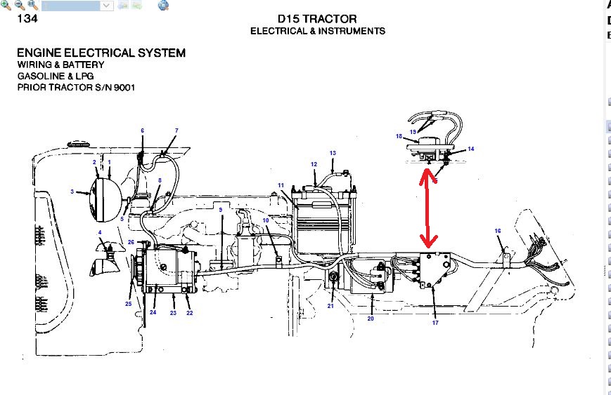

Is this it? Plate that held the voltage regulator and fuse for the lights.

Thanks Jim . That's it . Sure doesn't have anything attached to it . Hope someone put a ballast resistor on when they did whatever they did . I'm also thinking all D 15's are 12 volt . Thanks for the help
