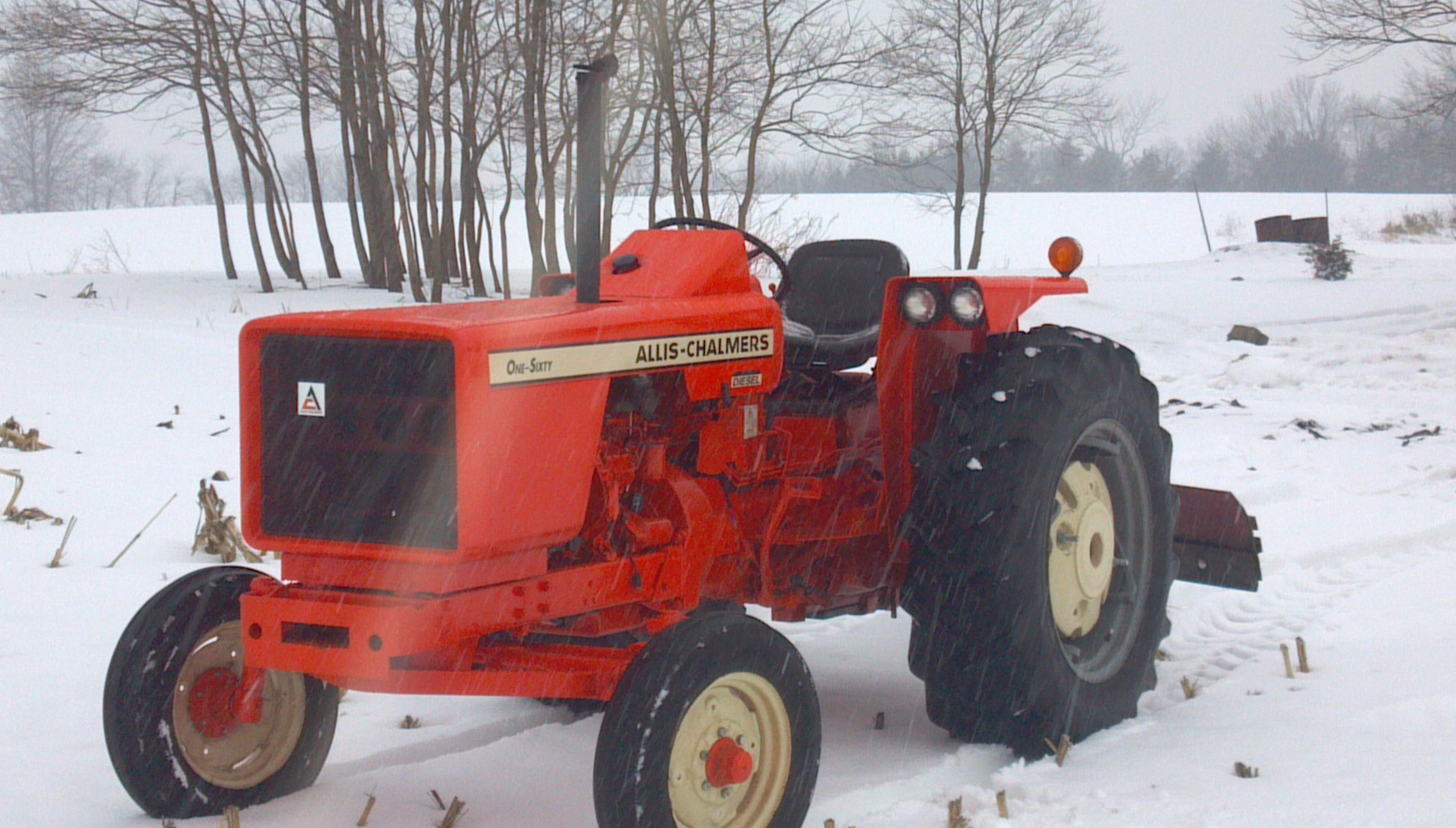

Well, it's finally on its way back together.  The engine has been rebuilt and it's sitting on four wheels again.  Pics of the project as it continues:
One rebuilt Perkins AD3.152:
Starting to put it back together.
Clutch is installed.  It looks a lot prettier than it did when I removed it.
Engine bolted back in place.  Getting the two-stage clutch aligned was a little tricky but a little patience goes a long way.
Frame rails and front wheels back in place.  I'm happy to have it back on four wheels.
Still a long ways to go but it feels good to finally get the engine and frame back in place.
An optimist sees the glass as half full. The pessimist sees the glass as half empty. The engineer sees a glass with double the required capacity.
