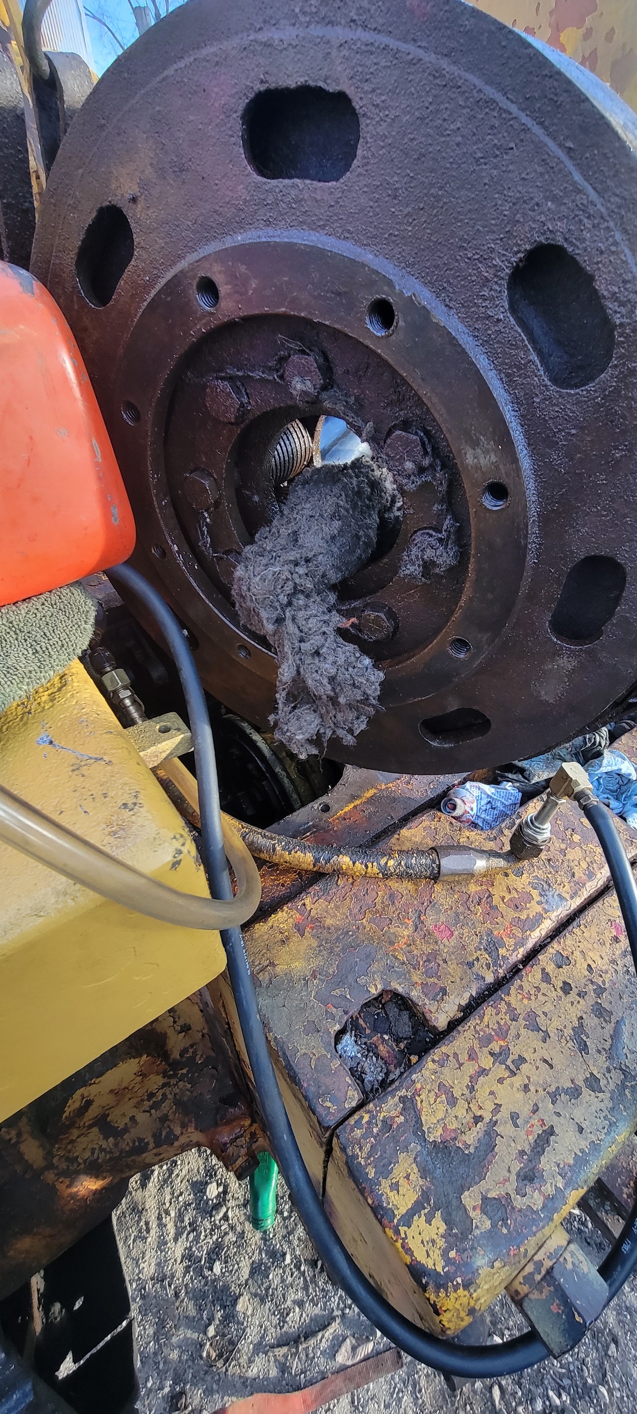

Well, a month or so of being submerged in diesel fuel, and a little hammering, and the steering clutch finally unseized from the drum so I could remove it. The entire center of the clutch was stuffed with shredded carpet and mouse .

Post Options Post Options   Thanks (1) Thanks(1)   Quote doctorcorey Quote  Post ReplyReply Direct Link To This Post Posted: 11 Mar 2023 at 11:24am
Three or four days soaking the entire clutch pack in hydrochloric acid, and was able to separate the clutch discs. They look like they were nearly new. I replaced all the steels, and springs. Installed grease hoses on the t/o bearing while I was in there. At least I saved the drum $$. That mouse pee, over time, becomes a good imitation of epoxy. Used new brake bands L and R from SC.com. My tractor is now ready to move dirt, but it's rained every day for what seems like a month, and this black Missouri topsoil likes to sink tractors. Still, even with replacing steering clutch and main clutch, I'm still under my $6,000 budget, and can lift, push, or crush anything on my ranch.

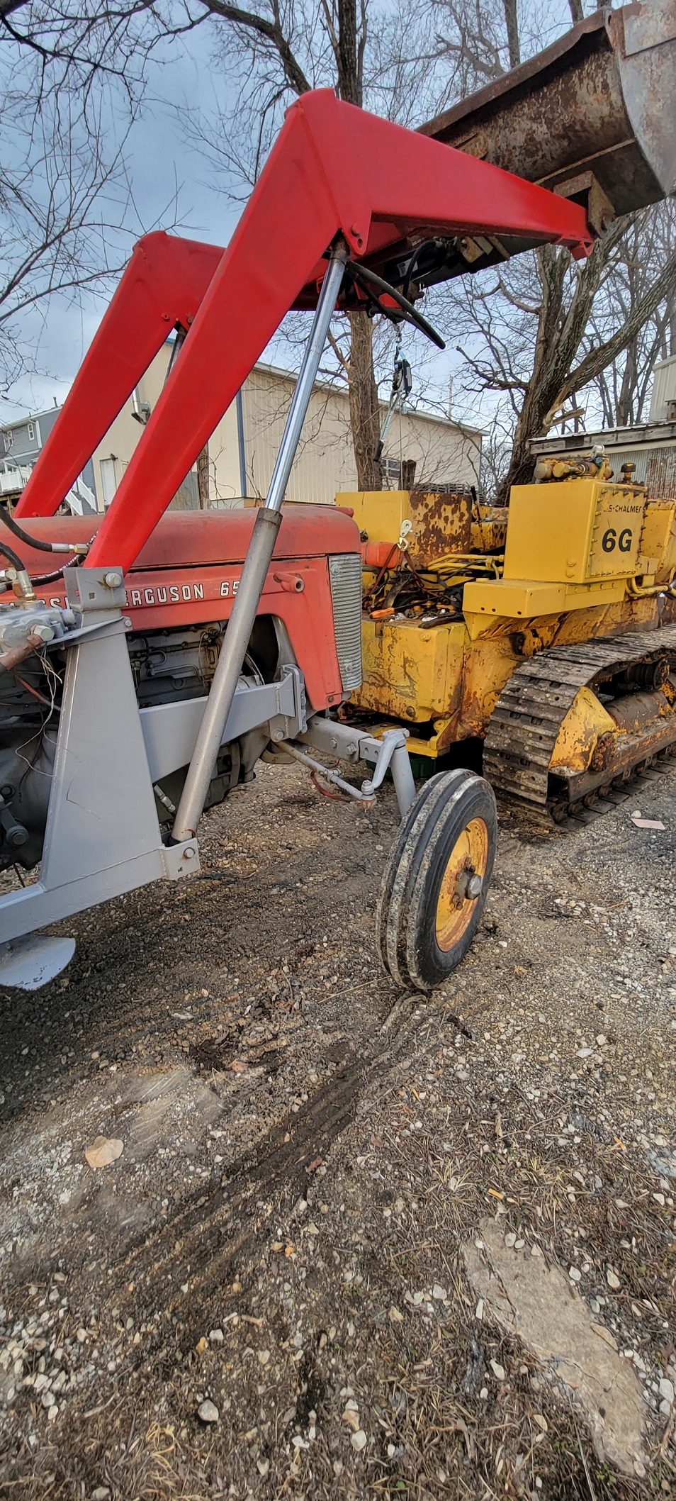

Thought I would post a Pic just for the heck of it. It just runs and runs.....

Post Options Post Options   Thanks (0) Thanks(0)   Quote orangeman Quote  Post ReplyReply Direct Link To This Post Posted: 23 Aug 2024 at 5:44pm
Nice muffler set up - where did you source?  ~ Orangeman
doctorcorey View Drop Down
Joined: 17 Jul 2011
Location: S. KC Missouri
Points: 589
Post Options Post Options   Thanks (0) Thanks(0)   Quote doctorcorey Quote  Post ReplyReply Direct Link To This Post Posted: 24 Aug 2024 at 12:19am
The muffler itself, I bought off of ebay, just shorty 3'' turbo muffler. The manifold I built from the stock piece, cut out the oval muffler and welded in a piece of heavy wall muffler tubing in it's place. I put the extension on top of the muffler to keep the fumes out of my face, but it provides a substantial arm/moment to strain the welds and clamp junctions due to the engine vibration.  Need to add a rubber suspended brace somewhere.
