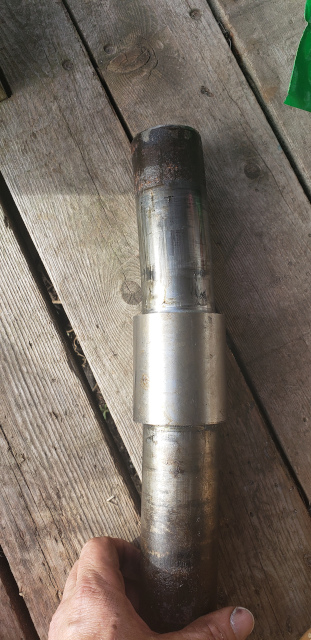

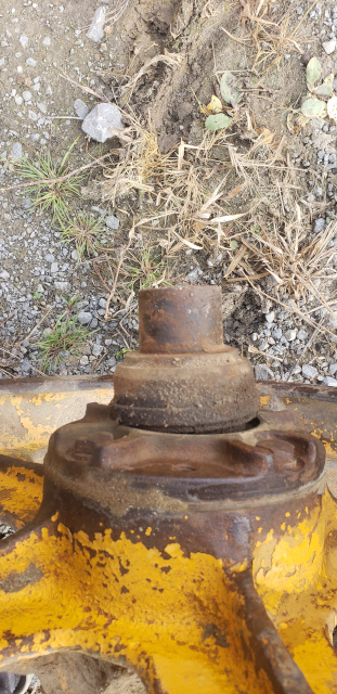

had some spare time yesterday so I took the front idler wheel off. one side had been welded to the track frame. buddy said a front bearing was shot but the bearing is fine, its the shaft that is bent! wonder how they were able to do something like that. should be able to turn a new one in short order thankfully. will take it apart tomorrow. the track adjuster is the hydraulic type. wondering if I should take it apart and clean it and put a new seal in while it is all apart? I put grease into it and it seemed to work fine as is. maybe I have answered my own question in my mind, new seal while it is apart.

Got the idler apart and indeed the shaft is very bent. All I could imagine is that one side being welded to the track frame and the other side free. Someone must have tried to tighten the track and bent it. Am surprised more was not damaged but the bearings inside are fine. I did break one seal and think someone said they may have a replacement. The spring mechanism is fine. Will hopefully get a new shaft turned this week unless someone out here has a used one!
