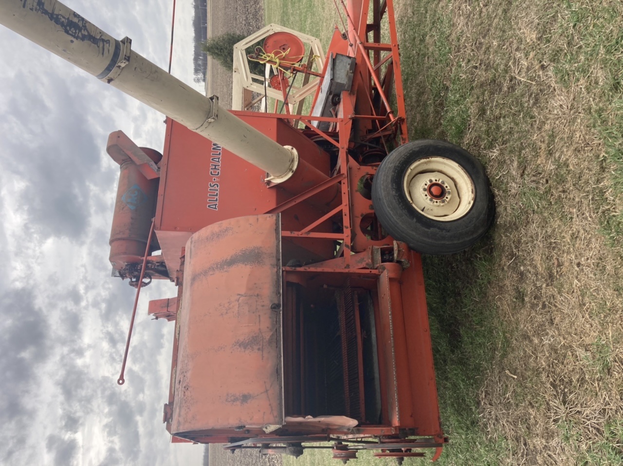

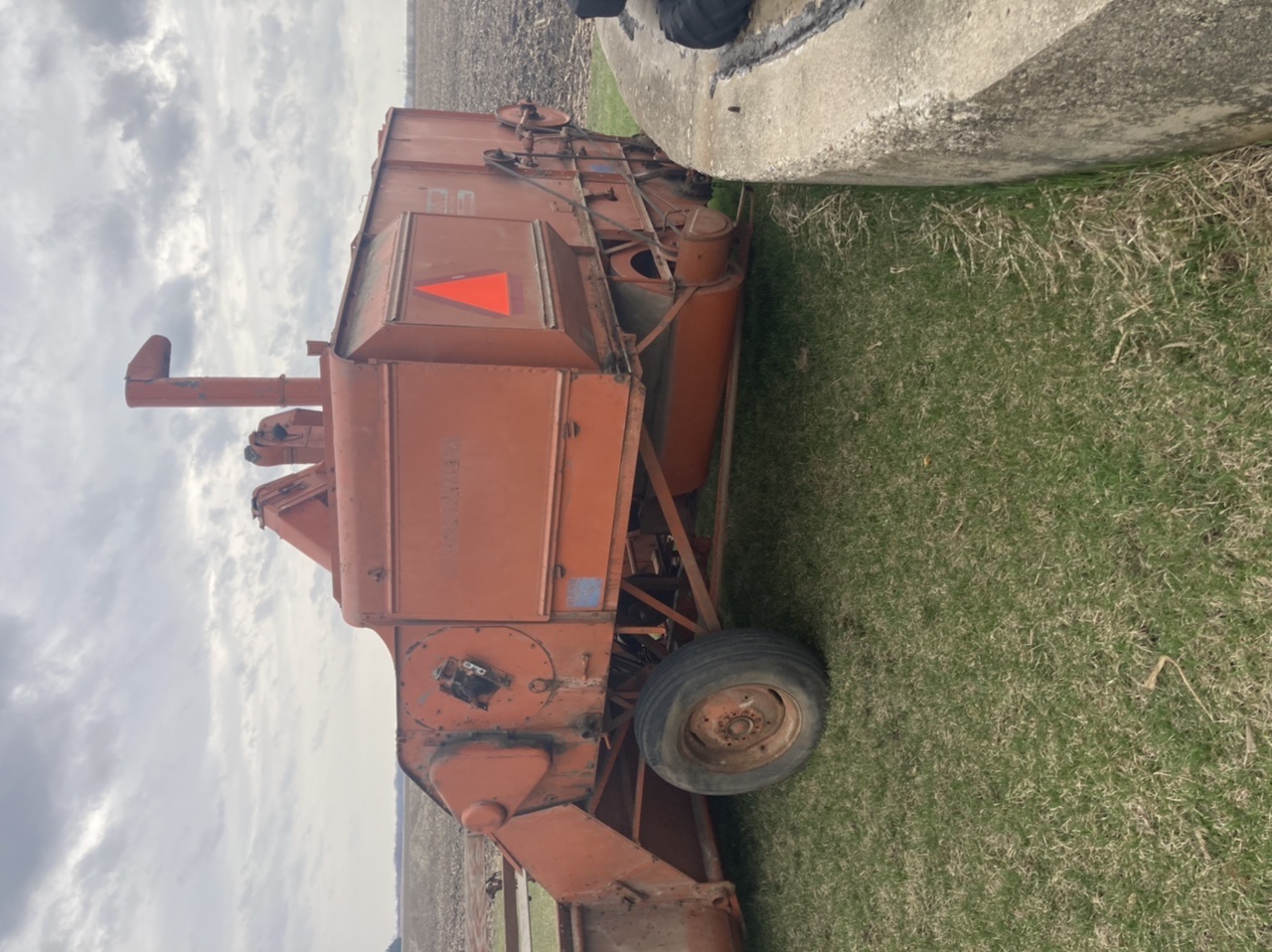

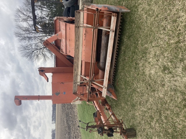

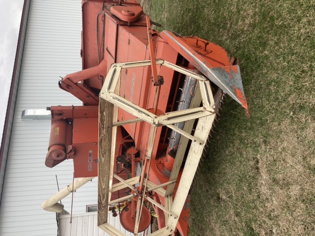

Ive been a lont time reader, never posted so now i have a good reason to.

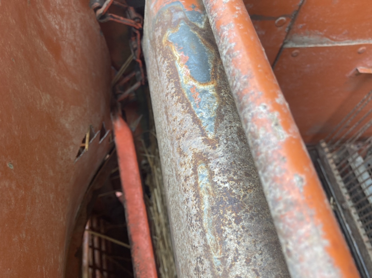

The other day i had dropped off a burn permit and headed north to go to a dealer and pick up some filters when i crested a small hill and there on the side of the road was a 90 and 72 all crop combine!  Now, ive been wanting a 72 combine for about as long as i can remember, so i swung around and checked them out.  The 72 had nice bright paint and looked about as good as any i had seen, the clean grain chain was in the tool box and the buckets are in poor shape.    The 90 was a bit more faded and the upper sieve had broke and got snagged on the chain, its missing the sickle and clean grain elevator chain also.
When i called, the owner came out of the house and told me the price, shocked at what he said, i bought them both!!  I Certainly wasn't expecting to find those machines 8 miles from home.   The 72 was likely bought new by the family selling it, the 90 was bought years ago but they couldn't remember when.
Both combines have the 3/8" lower sieve in them, which will work good this year as i have soybeans on the home farm.  Would like to find the wheat sieves for them.  Does anyone know are the finishing  sieves the same for a 72 and 90?  Through my collecting over the year i have manuals for 60's and the 90.

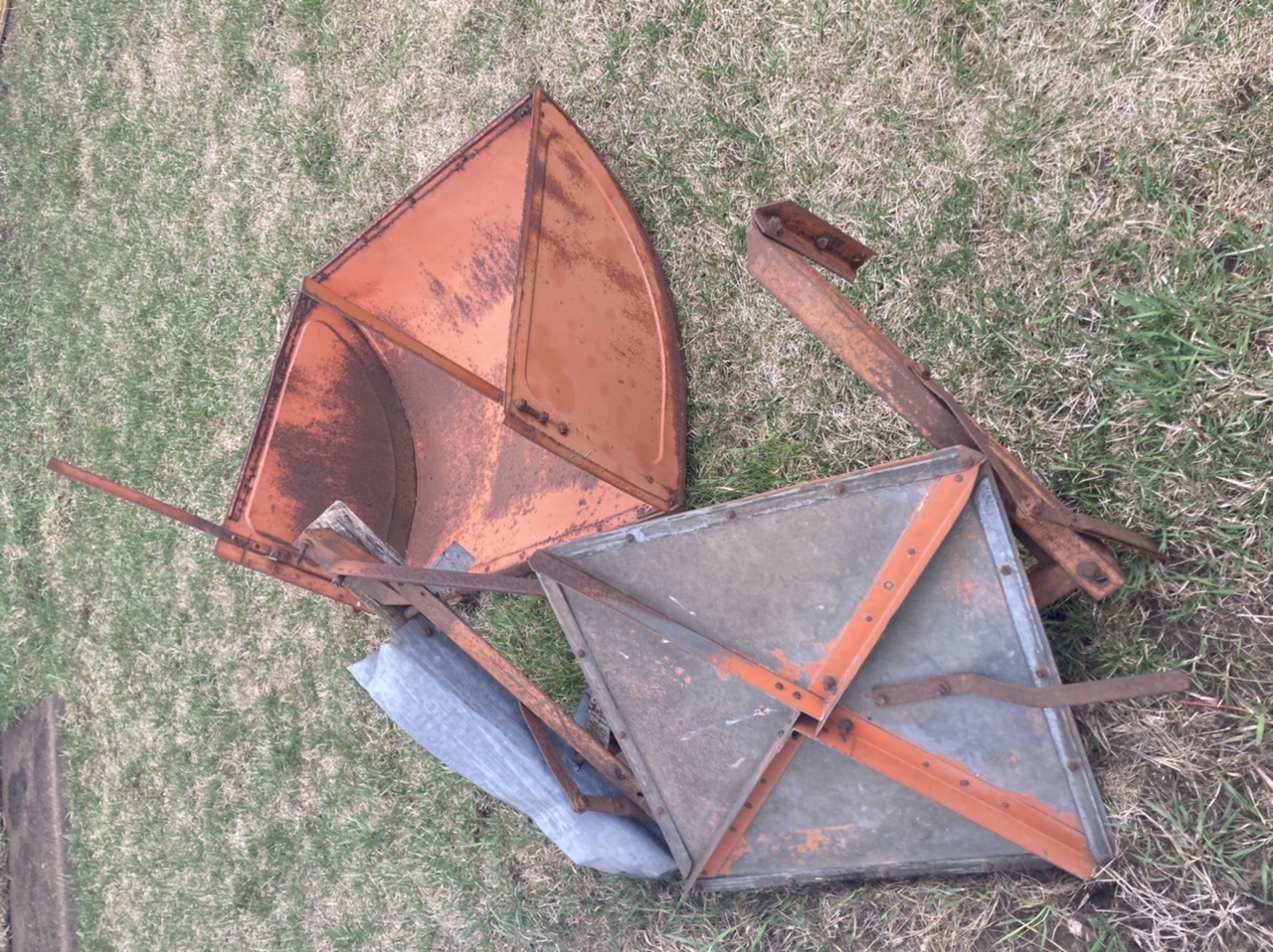

Yet another story, years ago i was given a 66 "was running when parked" situation.  Young and dumb i drug it home.  I started looking into it and everything on the bottom side was rusted out.  Head was twisted, clean grain elevator was bent, chain was missing( this must be normal???), basically a pile of junk.  Was able to save 1 scour clean screen and the straw spreader from it.

Well Darrel, they are nice looking machines!
To answer his question, the sieves are not interchangeable. I’ve heard that 90s are bad about breaking that grain drag chain, causing it to ball up, but as long as it’s kept properly tensioned, I don’t think it will be an issue once you get it fixed.
I like the straw spreader, and it looks like you have all the mounting parts. I have one on both of my 60As and really like them. Simple and do a good job spreading evenly.

The 90 and 72 screens won't interchange with each other but the 72 is interchangeable with the 60 & 66. It's an easy fix on your 90 if you have the time and you must keep the tension on the chain to keep it from breaking and wreaking anything. Watch the wooden chain guides as well.
