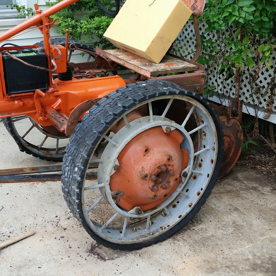

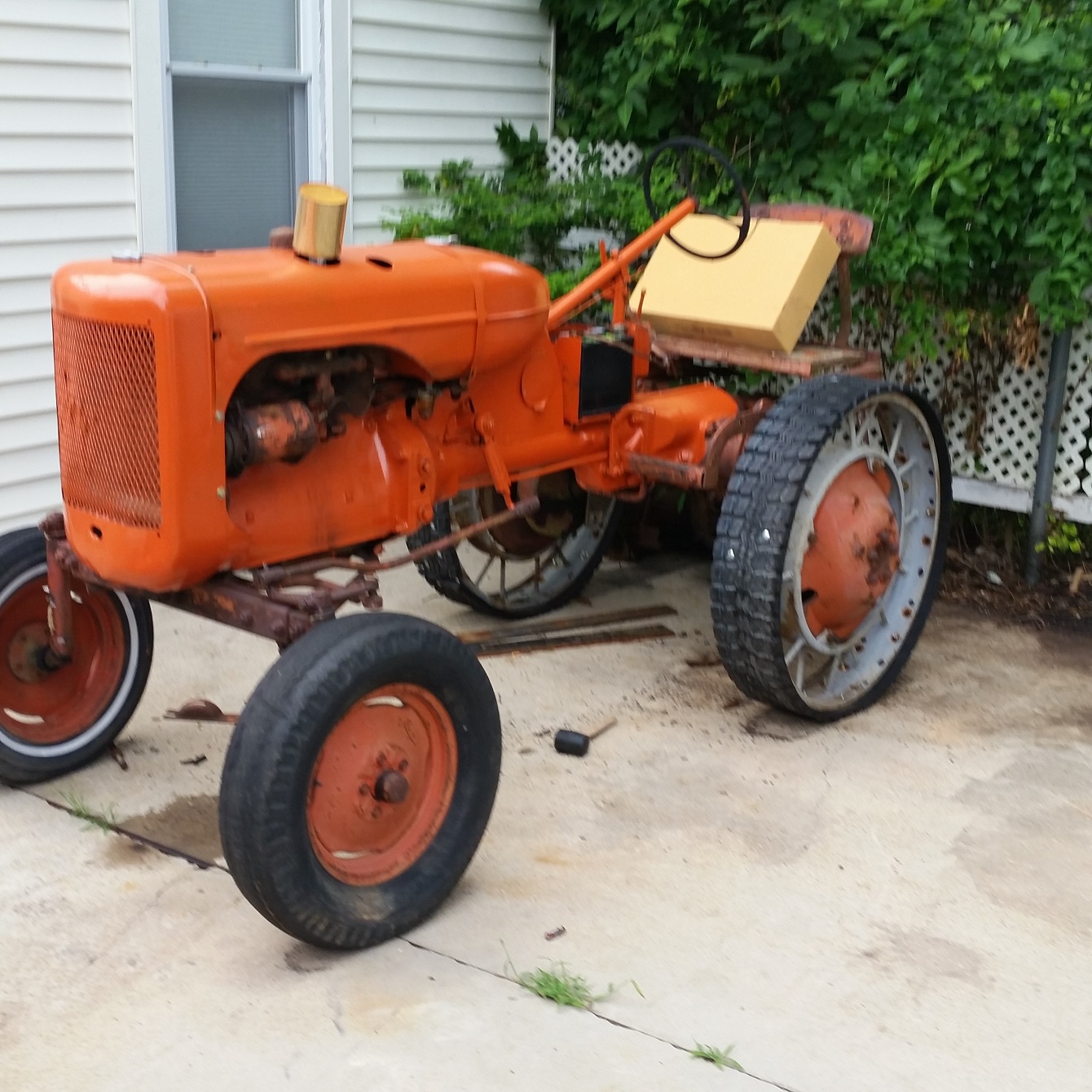

Thanks MnLonnie !
by the way Y'all, the rubber is Truck Recaps you know the rubber alligators that you see on the interstates..
Tire shop gave me a set of out of date ones... I just drilled and bolted them on.

Wow, those recaps look like they worked great. Nice job.

Looks great.Thumbs Up  Now you need a road gear.Stern Smile

Nice work.  I can see the pitman arm has been repaired like my Father's B was. I lost track of that B years ago.

The installation of the recaps looks great!
Good looking B you have!

Those look really sharp.
One question, Does the bolts holding the rubber down move when its rolling? I've been kicking around the same idea using some conveyor belting but I'm a bit concerned that the bolts will rub back and forth as it rolls, possibly wearing the bolts/holes.
I would think that if you countersink the bolt heads, and kept the bolts tight, it would not be a problem.
  If your planning on going on tractor rides, you might want to put several layers on, because the outside diameter of the rear wheels is considerable decreased, thus slowing the tractor road speed down.
  They do look good, but I don't think they are going to pull as well as the original steel wheels in the dirt. Might do ok in the rocks of the Tn mountains though!
