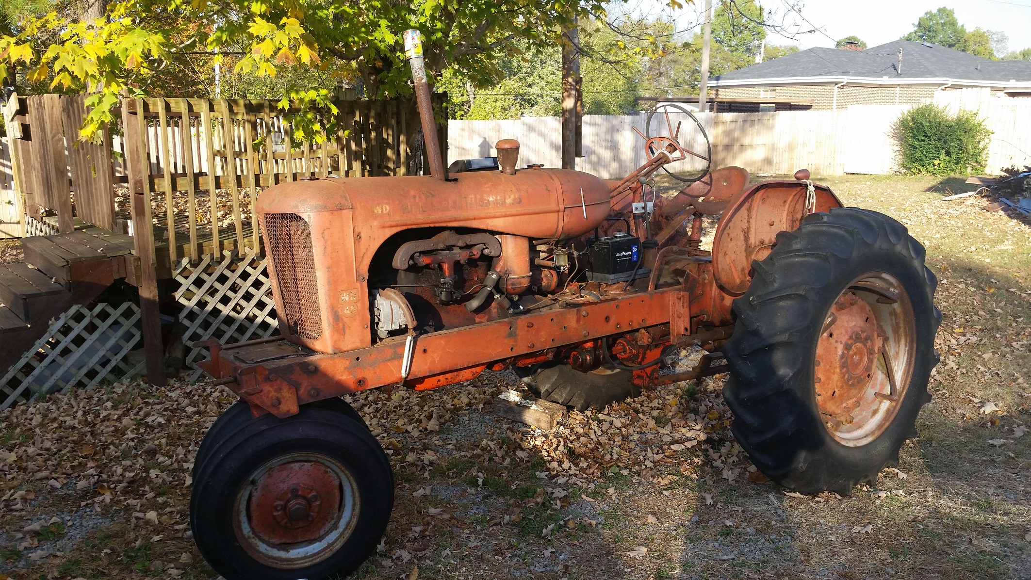

Looks nice!
I take it it's a WD, since it has a pin hitch, straight shifter, and WD decal (But it has a WD45 decal too?)
Either way, you'll like it. They're great tractors.

that's quite an alternator adjuster!

Yes, I like the alternator belt tightener

Looks like a good straight unit. Does it run good?

It didn't run, but a couple hours on the starter with new brushes and a new set of points and it runs fine....  I've been going over it some.
Just rebuilt the left side brake, the right is missing the pedal and the shaft is busted.
The hardest part was getting the pin out of the left...  WHEW. 2 hours with a slide hammer.
Hyd works too after adding fluid and adjusting the mech. That appears to have not been used in years...

Looks pretty solid! Good find!
