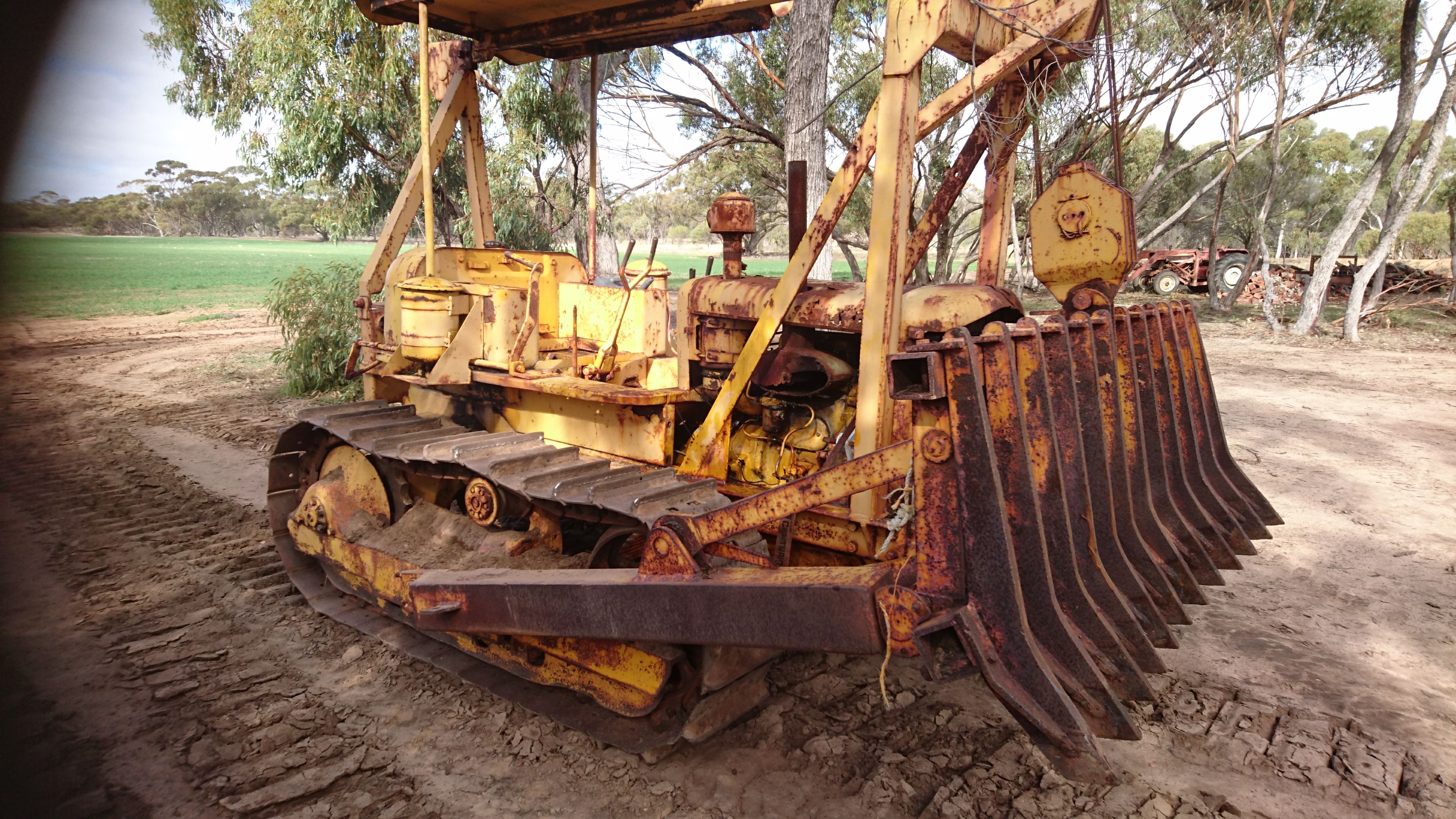

_IMG_000000_000000.jpg hi guy's new to the forum just picked up this 1952 model I'm in Western Australia hope to slowly get it up to scratch but has a broken drive axle and clutch seams to slip if not holding leaver back anyway should keep me busy for a while

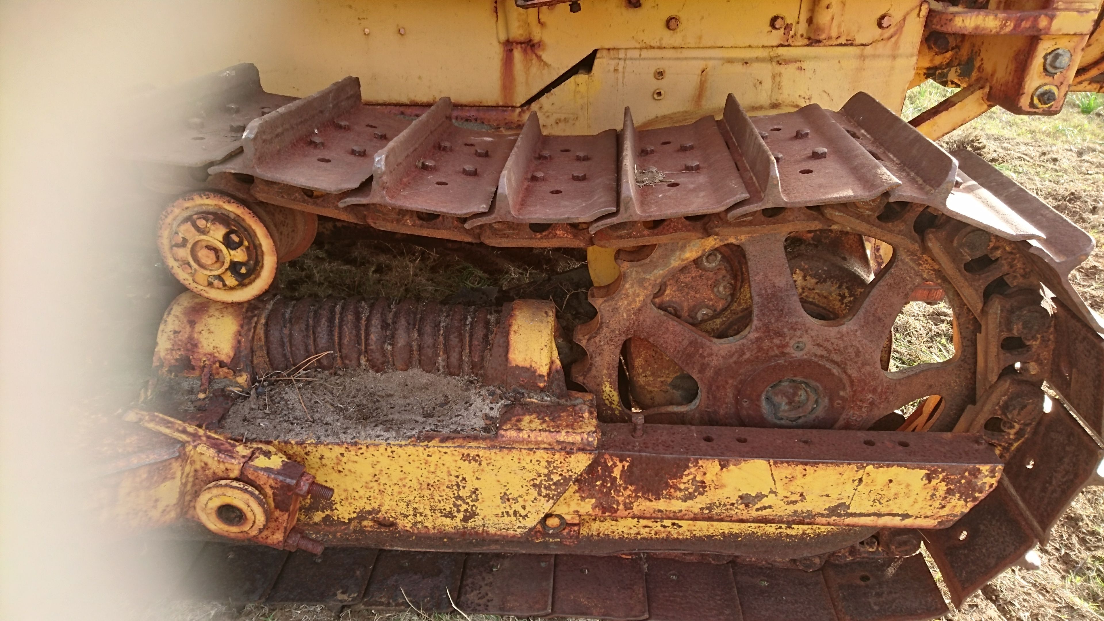

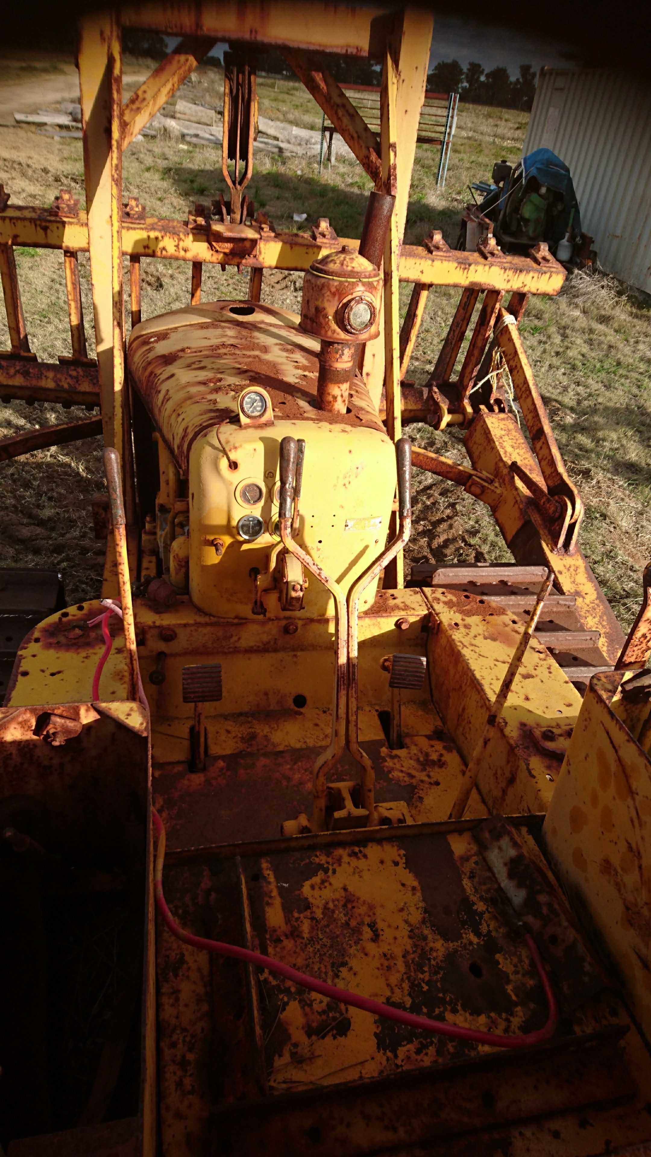

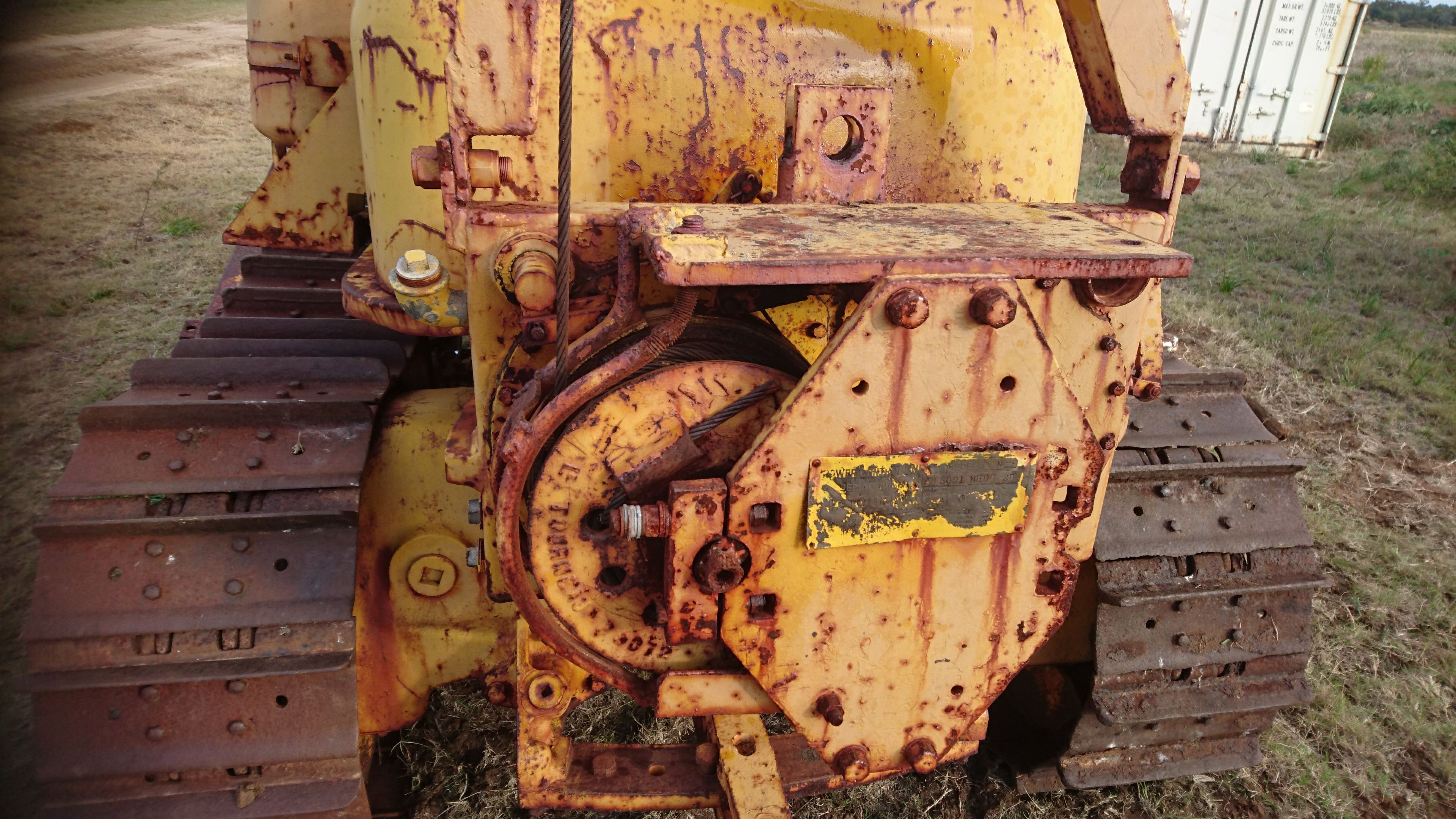

Here is a few more pictures of it has the letournea power control winch on the back
Coke-in-MN View Drop Down
Location: Afton MN
Points: 42263
Post Options Post Options   Thanks (0) Thanks(0)   Quote Coke-in-MN Quote  Post ReplyReply Direct Link To This Post Posted: 13 Aug 2017 at 11:05am
master clutch is adjustable through plate on right side of bell housing- need a 9/16 wrench and a pry-bar to move adjusting ring to tighten overcenter clutch tension
 depending of if dozer or loader will set the challenge for replacing broken axle .
if you search back there is a lot of info on HD5 on this site

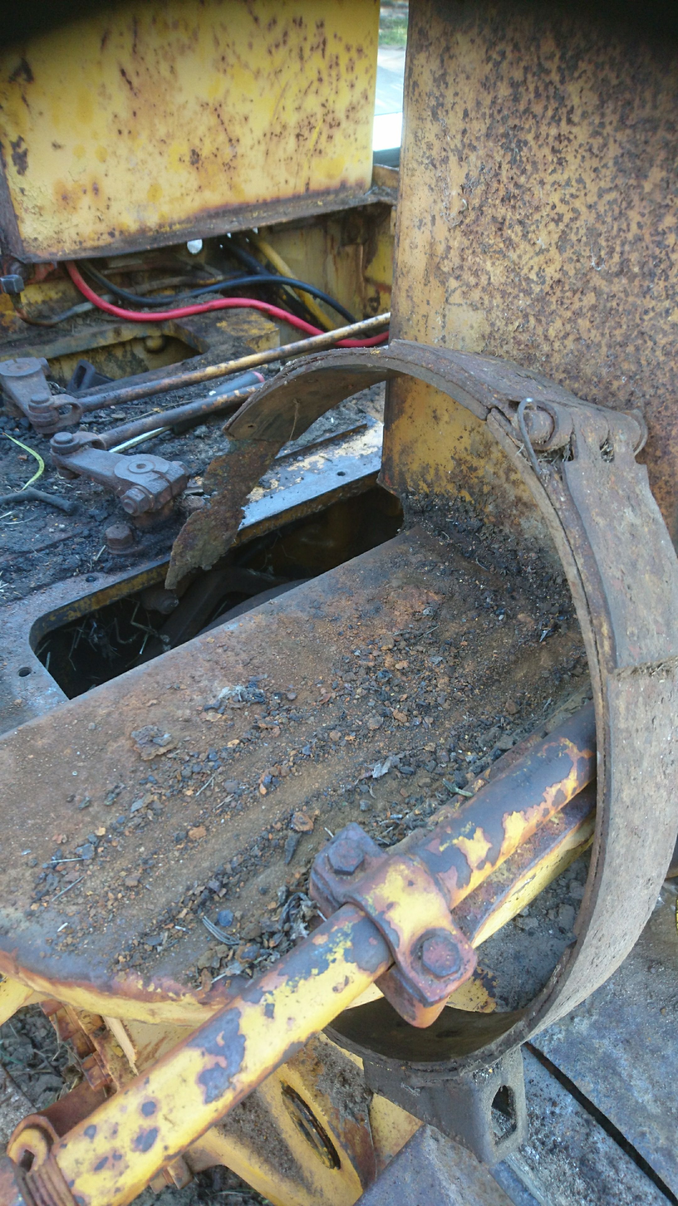

Had a look at the steering breaks today to see why the rhs break wasn't working and the culprit was rust
JC-WI View Drop Down
Points: 34613
Post Options Post Options   Thanks (0) Thanks(0)   Quote JC-WI Quote  Post ReplyReply Direct Link To This Post Posted: 28 Aug 2017 at 10:00am
A little JB Weld might fix that...LOL

Just wondering if anyone reckons I could get a break band of another dozer and adapt it to fit the Allis chalmers the price I got told for one wasn't cheep
Points: 34613
Post Options Post Options   Thanks (0) Thanks(0)   Quote JC-WI Quote  Post ReplyReply Direct Link To This Post Posted: 28 Aug 2017 at 11:02pm
The band was made by somebody to start with... just find another band and weld your components on...

Post Options Post Options   Thanks (0) Thanks(0)   Quote Wawill Quote  Post ReplyReply Direct Link To This Post Posted: 28 Aug 2017 at 11:21pm
That's what I'm thinking if it's made by man can be fixed by man
