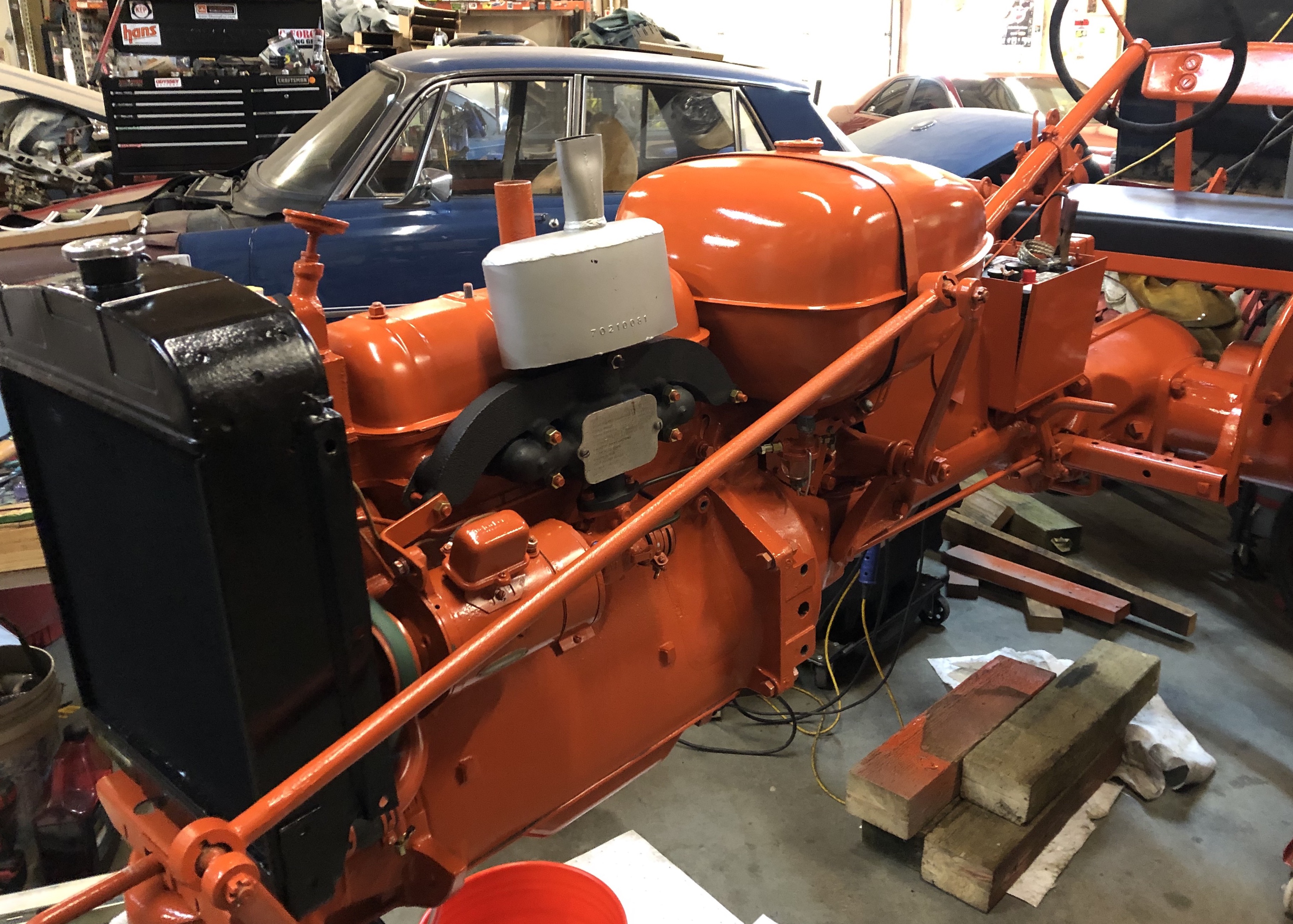

here is a picture of the C as I have been fine tuning her:)

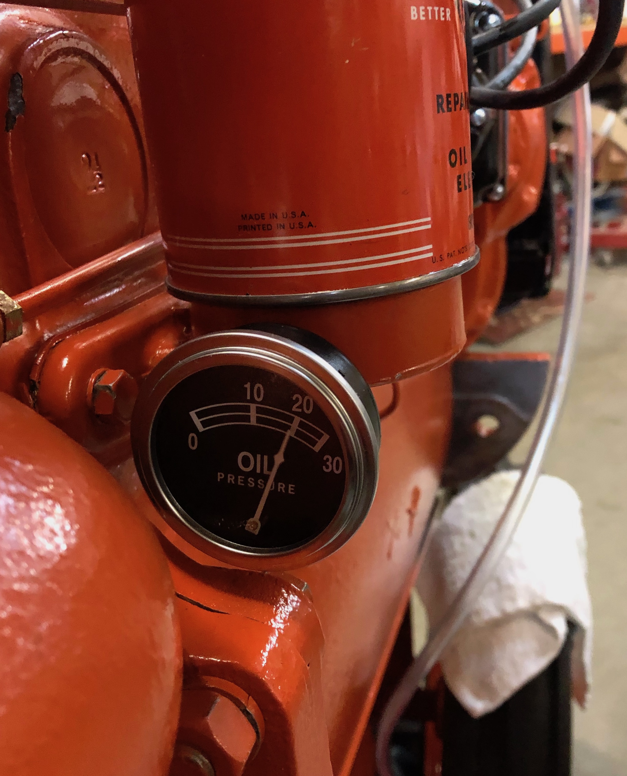

Well guys I have been making some progress:)
I now have good oil pressure and prime (most of the time)!!
What I did is take the tractor apart again and replaced the C oil pump housing with a B oil pump housing.  I put the new rebuild kit I had put in the C into the B housing.  The B housing looked a little better than the C.  I rechecked the new check ball. spring and its fit into the rotor and they were good. The main difference is I only used one gasket under the cover instead of two as on the C.
I had found an old 0-80 psi oil gauge off of a C tractor and tried it so I could see an actual pressure number. After I reconnected the tractor and tried the oil pump it would not pick up prime so I primed the oil pump and had some pressure on the old gauge.  The gauge measured about 2/3 way between 0-20 psi markers so this was much better:)
On Monday my new 0-30 psi oil gauge came in and I put it on the tractor to see what I got.  I did not re-prime the oil pump and tried it with the new gauge.
Well amazingly it picked up prime from sitting over night and the new gauge registered oil pressure and it kept climbing to 20psi:)Clap  It has settled being between about 15psi and 20psi depending on rpm and running temp it seams. It has keep prime all but one time when after running it 5-6 times it would not re-prime on its own.
Yesterday it had prime from the start and did not lose itSmile
Below are a few pictures of the gauge and the rocker arm getting oiledClap
On the rocker arm you can see the oil being pumped and moved along like it is supposed to be soooo I got oil everywhereWink

That looks like pretty solid oil pressure for a C.  What does the tube that goes up inside your oil filter look like?  Is it sort of rounded off with a small hole?  Or just a straight hollow tube?
And by the way....WOW!!  Your photos went from rust bucket to shiny!  That thing is really looking good.  Were you able to save the original gas tank, radiator, tool box?
Points: 12071
Post Options Post Options   Thanks (0) Thanks(0)   Quote Steve in NJ Quote  Post ReplyReply Direct Link To This Post Posted: 14 Apr 2021 at 2:20pm
Man, you've been hammerin' on that baby!  From junk pile to a shiny gem that runs! Great job so far. I'm wit' Steve. Sounds like a fuel delivery problem......

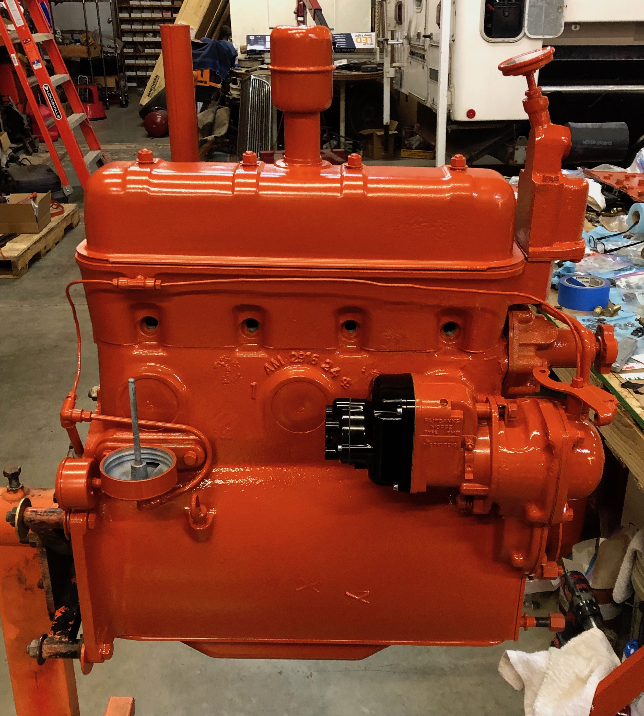

Here is a picture before I got the valves adjusted and started the engine the first time.  I was dry fitting everything to see how they fit but getting the radiator and cowling to fit was time consuming.
I have a lot of pictures on the rebuild and video of it starting and running but they are two much for this site to store.  I am working on getting them on my Dropbox account so everyone can view them.

how about a little story about the PREP , PRIMER,  PAINT... what brand ?  Looks VERY NICE !

Luke114 ... the oil tube in the oil filter is hollow with two side holes at the top along with a hole at the very top. The top of the tube is rounded.  Below is a picture of the tube and you can just see the side holes and the top hole and rounded tub. You should be able to zoom in to see the holes better.
Luke114....The new parts are the battery box, door to tool box, water pump, and seat.  The fenders, instrument box, gas tank, front rims and one rear rim are off a C parts tractor as original ones were two far gone. The tires are off a C and B parts tractor. The radiator core is new but housing is original. The cowling, hood, tool box, one rear rim, and all main parts are original but cleaned and rebuilt as needed.
