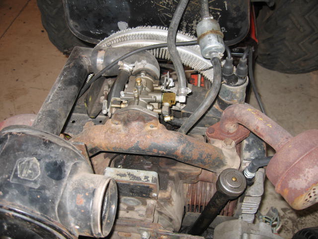

The points box is located on the front of the engine below the intake manifold.  Picture shows the rectangle shaped box housing the points at the end of the air intake (not a standard set up, it was a mod some previous owner had done)
