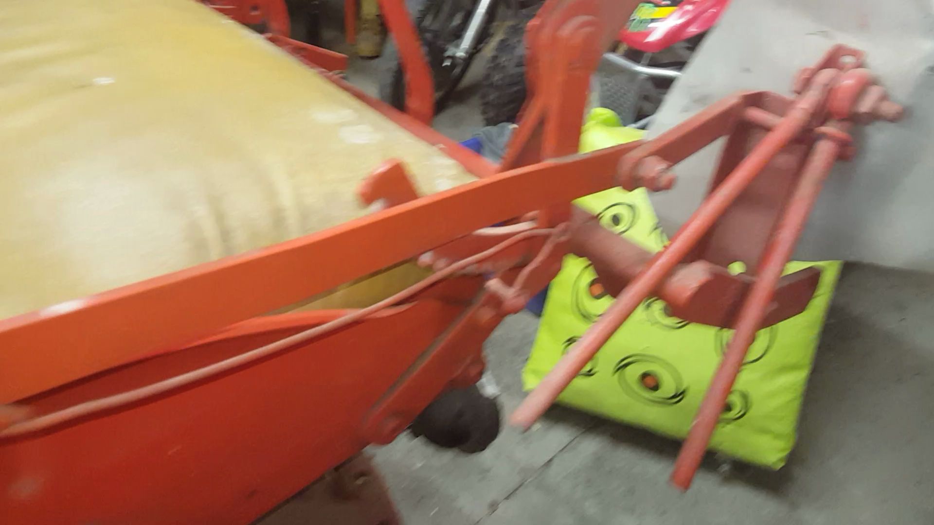

You may be able to figure out how those rods worked the cultivator by reading over this thread.  The linkage under the foot brakes may be for lifting several attachments, including a  front blade. My tractor has the link. It is not needed to operate the 80 series cultivator. However, this C did at one point have the front blade, and the right and left  rear plows.
http://www.allischalmers.com/forum/forum_posts.asp?TID=78211&title=allis-chalmers-c-cultivator-setup

I see in a couple of photos a pair of brackets bolted with two bolts to the top back side of the final drive housings between the tire and fender. I see them left on lots of Cs. They are part of a C Cultivator set attaching hardware package. What they do I can't remember. I think they are part of the rear gang that lift after the front gangs at the end of the row
At one time there were plenty of C attachments to go around. Putting together a complete plow or cultivator set these days is a real challenge.

Those rods on the back of your lift arms are for the C cultivators. You already have the brakets for the mounted plow, but there was also a sickle mower and a planter that one could get for the C. The white oily goo on the valve cover is from condensation. I would say you do not have any coolant in you oil, otherwise the oil on top of the cylinder head would look milky. Your overheating problem might be a too lean of a carb setting in addition to some of the other problems mentioned above. If you have any other questions, feel free to give me a call at 920-598-1287 Congratulations on your new orange tractor!

As stated, the rods attached to the rear rockshaft are part of the cultivator lifting mechanism. There are tubes the slide over the rods and go to the front cultivator gangs. The plow drawbar is the gadget mounted under the tractor. It only raises and lower a shot distance because it is the depth control for the plow. The plow itself lifts off of the rear rockshaft. Fun littler tractor you have, enjoy it. LOL Bob

Wish I had the cultivator. I'm gonna have to try and find a picture with that style drawbar and linkage to get an idea of what to even be looking for. This is all very new to me yet. If you told me a year ago i'd have 3 vintage tractors I would have laughed at ya and told you your nuts. Crazy how fast things turn around. Seen that ford for a great deal and it came with a loader, a rotary cutter, and a rear blade my father and I decided it would work good for pulling firewood trailers and leveling the driveway. Now we have a fleet and the attachment are piling up too. You find all kinds of uses for them once you have them.

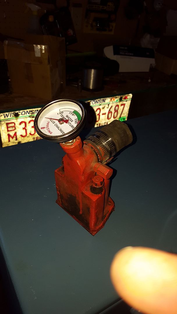

One other question here. What is this capped fitting for on the side of the thermostat housing? Just to burp air out of the system?

Looking along the right side underneath the seat is the one cyl. This indicates to me that it was used to plow with. For the cultivator it had two sets of those rods the guys have been talking about that run from the back to the front. It also had two cylinders, one to lift the front gang and one to lift the rear sweeps. (3) This was made so you could plow your rows all the way to the end. There was a two way valve that you could control when they lifted. There are fenders too that hang by a small chain inside each gang that you could adjust up or down to control how much dirt was put to the plants without covering them up. We always liked the spade shovels up front because they covered better, and then the crows foot on the three rear sweeps. Actually we left the middle one out until the last cultivation because if you plowed out the middle the first time through it was a son-of-a-gun to hold that little tricycle straight. Way back in a smaller, slower time, they couldn't be beat in keeping corn and beans clean. And they were unbelievable in how little gas they used. It's made tears come to my eyes to think I or anyone else will ever see those days again. I wish that I had a 20-30 acre plot of ground and all the equipment we had for a "C" just to play with. What a time we would have. Guess I'll have to be satisfied with the 45 and the stuff I do with it. Sorry for such a long commentary, but it  is  what it is. LOL

Anyone have an idea what that cap on the thermostat housing is for? I'm missing the spring for inside there. I'd assume that doesn't come with a new thermostat by chance does it?

Most thermostat housings don't have that pipe cap sticking out the side. I'm guessing sometime between 1940 and 2016 someone added it to bleed air, or put a preheater on.

I'm pretty sure I will end up taking the cultivators and the single bottom plow setup but as far as thee tractors I don't have room or really need a complete parts machine laying around at this time. If your seriously interested I can talk to him about it and see if he would sell it if you would like.

I would sell the 1 bottom plow that I have for $150 and the cultivators for $50. If you can get them cheaper, that would be a great deal. A extra parts tractor would be handy to have around just in case, but if you don't have room, maybe just take a couple key parts and put them on a shelf. If you or Ted decide that you don't want any of the tractors, I would be interested.
