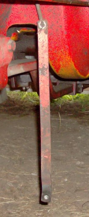

It looks like the rod going to the PTO is hanging down in the photo if you look at the left rear wheel you can kinda see it.  I'm thinking the rod just needs welded back on going into the housing.  Good looking early XT, looks like it has the light axle's and interchangeable front end also.

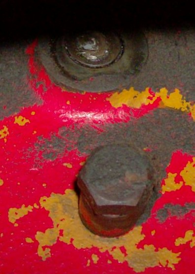

Thanks for all the responses!  Here's a picture of the bar/shaft hanging down - you can see at the bottom where the rod sheared off flush against the shaft.  Also a picture of the housing.  I'm still looking for some diagrams of what is inside the housing to figure out how things work in there, so here are my next 2 questions!
Question 1 - Since it is all flush, both against the shaft and the housing, is that weldable?
Question 2 - what's the chance that something inside the housing "blew up"?  Or is more likely that the rod just sheared and a weld will fix it?

I would guess that your lever just broke.  The proper fix would be to split the tractor and replace it, but it can be welded.  You will have to drill out what part of the shaft that broke off in the lever hanging down,  weld a small chunk of shaft on the shaft that is broken off, then weld your lever back on.  There is an O-ring that seals on this shaft and it might leak some oil after welding on it.  I can get a part break down later if needed.

 Heres what I would do... I would drill the shaft out of the lever and place lever up against the shaft in housing. Then grab a wire feed welder and weld two tacks (one top , one bottom) to hold the lever. have a water hose close by an cool it down. Then weld it hard on one side and cool with water to touch, Then weld other side and cool down again. - Spray the water on back side to cool it so housing and shaft get the cooling and possibly save Oring.
