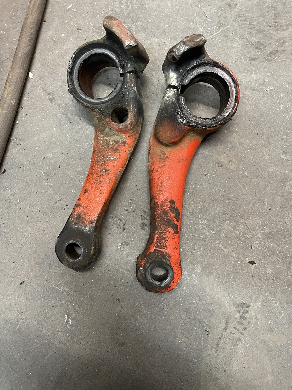

Back when I first got the tractor, late 2005, I worked the extendable front axles loose as were frozen in place, Tie Rods were already loose in Ball Ends so also replaced those and had one Cracked the other loose on spindle steering arms.  Bought what could find thru a Local AGCo Dealer and thought received good parts in 2006.  No so good as it ends up.

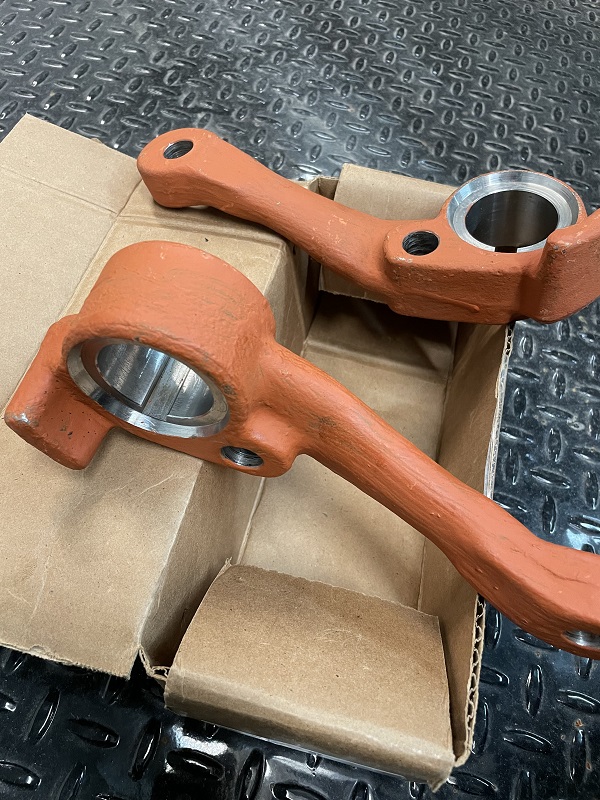

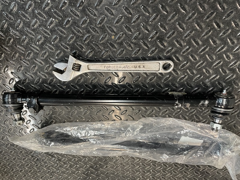

Last few years had issues with Outer Tie Rod ends coming loose in Arms and having to retighten nuts, Cotter pins ended up outside the castle nuts, then noted they were wiggling IN the taper hole in the arm.  Pulled loose as was fighting Locust Thorn Flats last week to find the holes wallowed out.  Tie Rod Ends are ALL loose in sockets so ordered new tie rods and Steer Arms.  Tie Rods came from Reliable Aftermarket Parts and to me appear heavier than the last ones.  The Steer Arms came from All States AG Parts, are not simple Castings as my last ones, these are Forged and Machined included the Axle Drift hole to slide the axles in or out.  Will grab photos as get it fully apart and back together.

Sockets on tie rods took a beating, are getting changed, will take the arms off as well as have new. Run this on county road more often than not so do not feel comfortable patching steering.
Got tie rods off today, holes in the arms are close to .130 oversize to taper on new ones. Fo appreciate all the suggestions, had run the same thought myself but depend of the old girl.
Points: 35599
Post Options Post Options   Thanks (0) Thanks(0)   Quote DMiller Quote  Post ReplyReply Direct Link To This Post Posted: 27 Oct 2024 at 12:49pm
All swapped this morning, As to the Torque, a 1/2nc" hardened thread should torque at 100lbs +/-, 5/8nc to 150 where these are 9/16nc" thread, larger 7/8" nut.  Torqued to 120-140lbs should be effective.
Rattle guns have their place, just some places I do not go with them.
And Yes, I cheated to get the old ones off, 4 1/2" cut off wheel at Key slot, crack last little bit with cold chisel in that slot slide right off.
