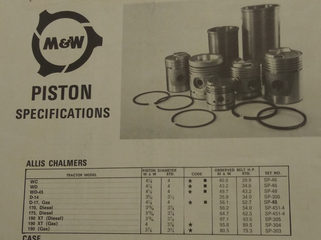

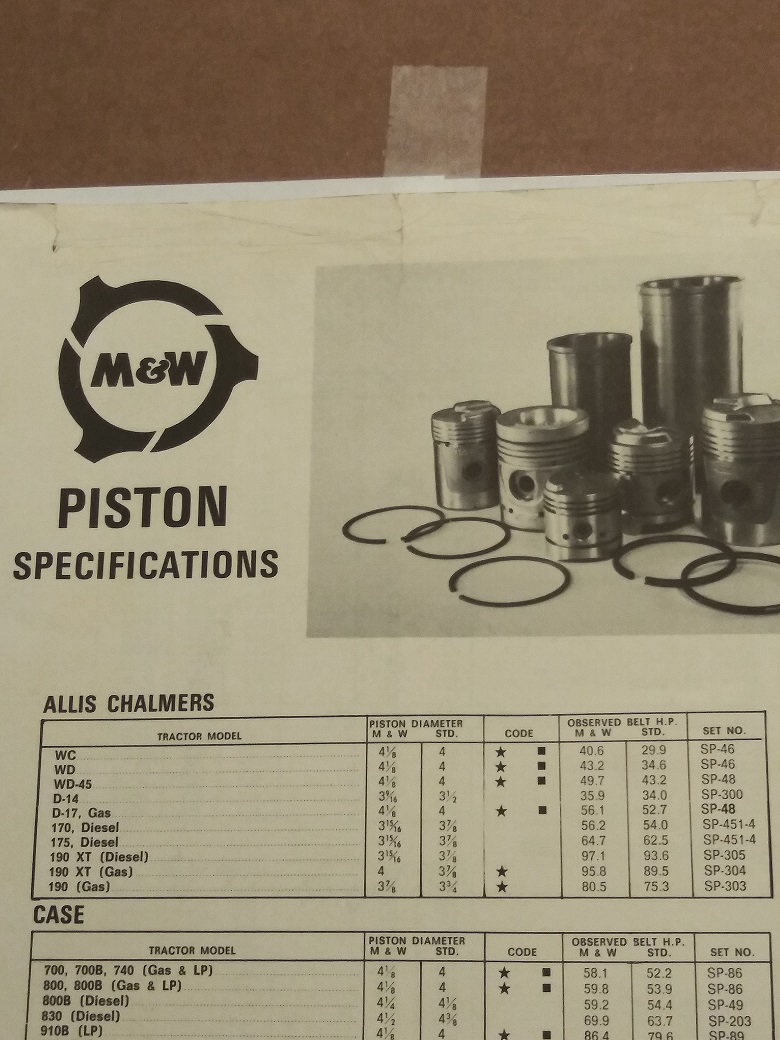

Looks good. I have M&W engine kits in two of my Deere 3020's and one 4020 diesel. They sure run good. In my soil you need to spend a day shinning up the plow bottoms before even thinking about plowing as the dirt will just stick. I was from Maryland and our soil there we could pull a plow out of the fence row where it was parked for 10 years and two rounds latter have it shinning like a mirror not here in WI. Tom

I have an old set for a wd, wd-45 etc. old stock still in box. was going to put them in the 45 with the stuck motor but will never get it done. ---back in the mid 60's everything had M&W in them.--big rage back then. ---Problem I see with the oversize stuff is that the starters never work after you put them in, pull starting is fine but takes 2 to do!
Ed (Ont) View Drop Down
Joined: 08 Nov 2009
Location: New Lowell, Ont
Points: 1522
Post Options Post Options   Thanks (0) Thanks(0)   Quote Ed (Ont) Quote  Post ReplyReply Direct Link To This Post Posted: 13 Apr 2020 at 7:10pm
So do those liners fit the stock holes in the block? 1/8” is a pretty big gain. And 6 hp is a big gain too. Must have different compression ratio as well for WD45?
SteveMaskey(MO) View Drop Down
Location: Wellsville, MO
Points: 627
Post Options Post Options   Thanks (1) Thanks(1)   Quote SteveMaskey(MO) Quote  Post ReplyReply Direct Link To This Post Posted: 13 Apr 2020 at 8:21pm
Yes Ed (Ont) they fit in the stock holes. 1/8 inch over and higher compression made a noticeable difference in the WD, WD45 and D17 that we used
HD6GTOM View Drop Down
Joined: 30 Nov 2009
Location: MADISON CO IA
Points: 6627
Post Options Post Options   Thanks (1) Thanks(1)   Quote HD6GTOM Quote  Post ReplyReply Direct Link To This Post Posted: 13 Apr 2020 at 8:25pm
I think they had a souped up starter to use with a M&W kit.
Points: 627
Post Options Post Options   Thanks (0) Thanks(0)   Quote SteveMaskey(MO) Quote  Post ReplyReply Direct Link To This Post Posted: 13 Apr 2020 at 8:35pm
Dad moved the brushes on the generator to make it charge a little more and used a 8 volt battery. Over the years I think we broke 2 starter noses. They did make a gear reduction starter but we never did have one. Puled 3-14 with the WDs and 4-14 with the 17 in some pretty tough ground. This was back in the 60’s
