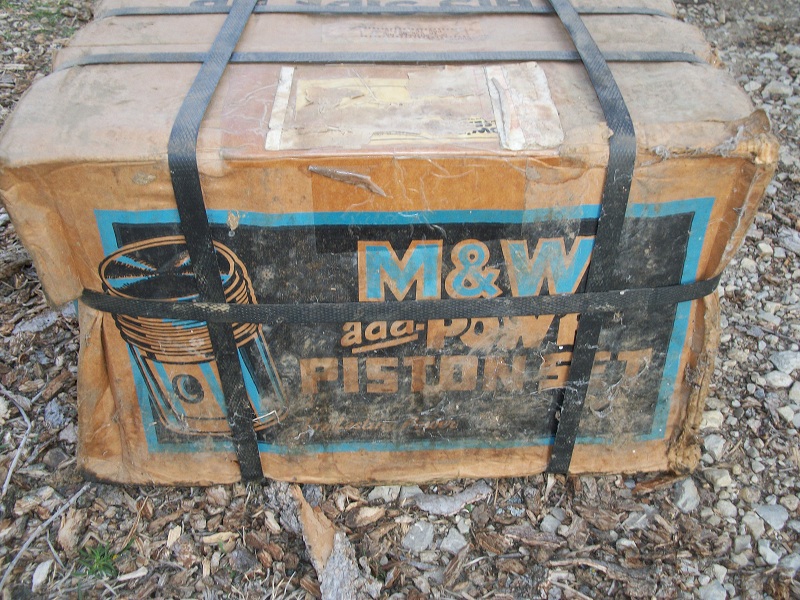

Post Options Post Options   Thanks (0) Thanks(0)   Quote SteveM C/IL Quote  Post ReplyReply Direct Link To This Post Posted: 05 Mar 2012 at 9:48pm
Wasn't there a good and better set? The better ones had ribs on the outer wall and I think the head land ring.That old I'd buy some new o-rings.If they were kept well they should be rust free yet.They were good stuff.

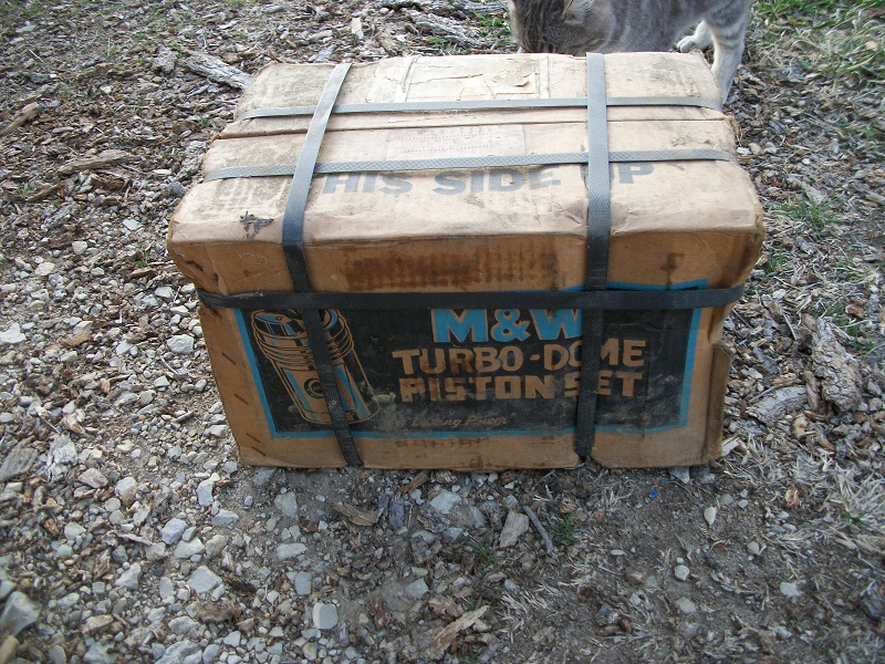

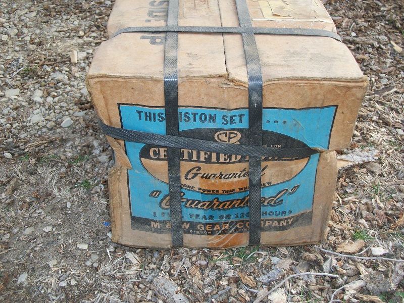

Post Options Post Options   Thanks (0) Thanks(0)   Quote CAL(KS) Quote  Post ReplyReply Direct Link To This Post Posted: 06 Mar 2012 at 9:10pm
here is the kit

Post Options Post Options   Thanks (0) Thanks(0)   Quote ALLISMAN32 Quote  Post ReplyReply Direct Link To This Post Posted: 06 Mar 2012 at 9:31pm
Its been many years since i put a set of those in an engine. I dont seem to remember anything different on the outer part of the sleeve. I do remember the bore being slightly larger than original. All the ones we put in had the L shaped ring on top of the piston. Engines with the M&W parts always seemed to have better power and started good when cold. No ether required below 40 degrees!!  If the rings looked good i would use them, definitely would use new o-rings on the sleeves.

Post Options Post Options   Thanks (0) Thanks(0)   Quote Orange Blood Quote  Post ReplyReply Direct Link To This Post Posted: 07 Mar 2012 at 6:07am
Hey they even come with a 1 year 120 or 1200 hour warranty.  Wonder if it still applies?  :-)
