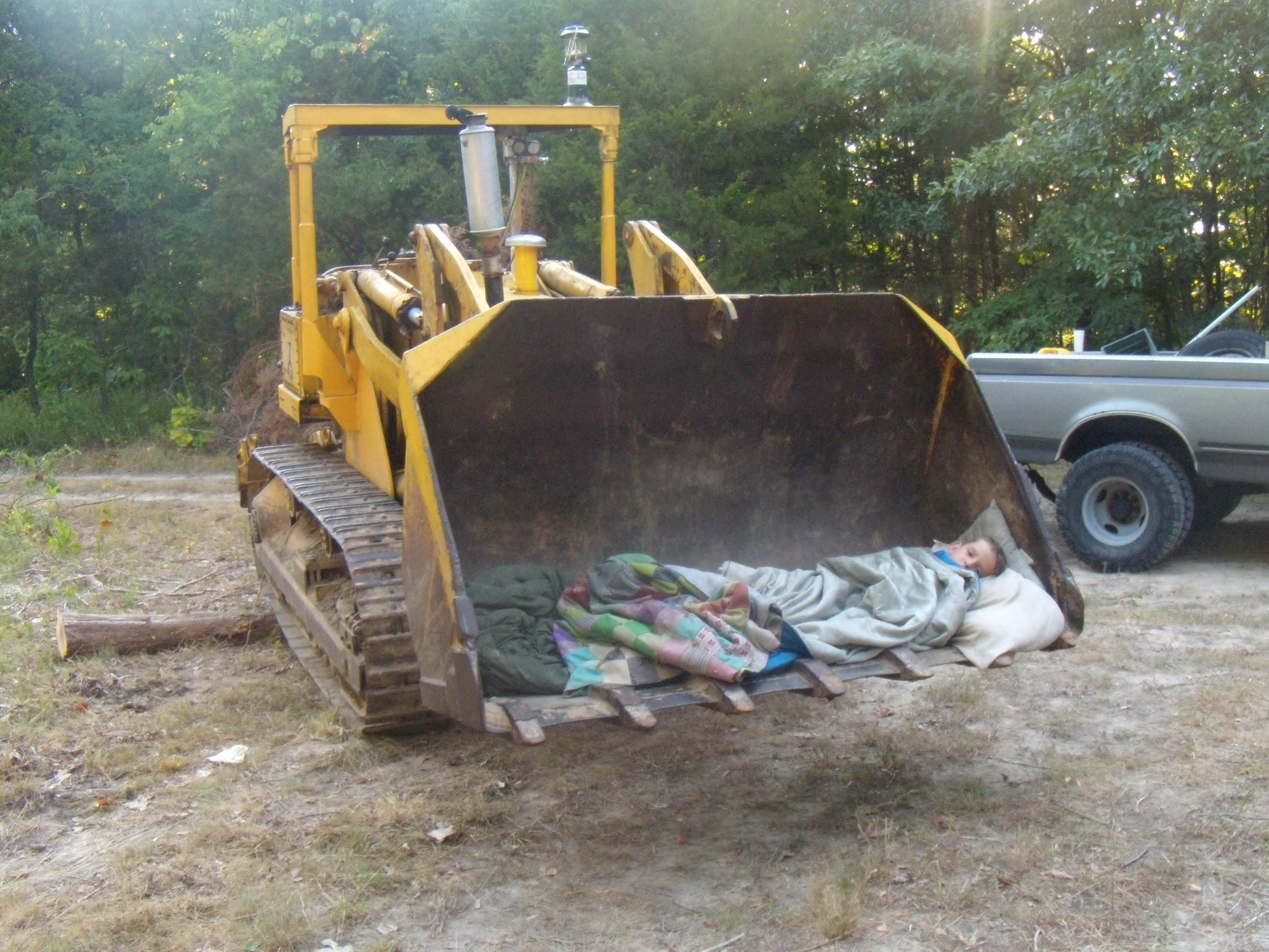

There were armadillos in the area.......
Post Options Post Options   Thanks (0) Thanks(0)   Quote CTuckerNWIL Quote  Post ReplyReply Direct Link To This Post Posted: 16 Jul 2012 at 6:44pm
Hope the bucket cylinders don't leak downLOL

Still pretty cute, you get your control valve from the old boy in Illinois to stop the bucket creep Corey?

  No new control valve yet. I'm going to pull down the lift rams and repack them. I'm waiting for my new tranny pump to arrive so I can straighten out my pressures first. Then I'll finish my restoration. The machine works just fine, but I like everything to be in the "green". Smile
