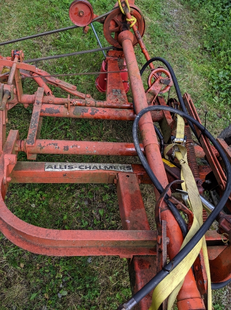

What model number and what is value?  Apologies for the bad pics.

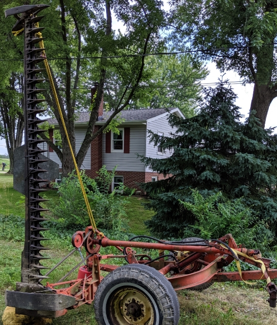

another shot

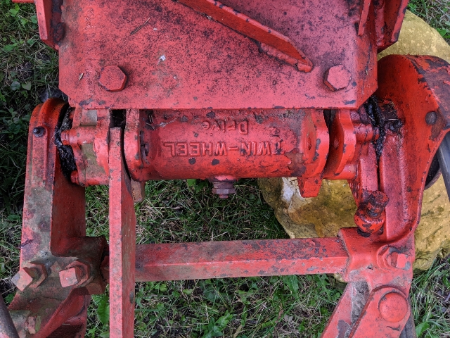

3rd pic

82-T, as to value, first check where the twin wheel drive meets the blade bushing.  If its loose, it may have insurmountable problems, unless you can find the parts, which are made, unfortunately, of unobtanium...Wink

Neat mower, appears to have been kept inside.

Like said what its worth is what condition the Twin Wheel Drive parts are in,I have one I quit using went to a 456 New Holland the drive set up on a NH is better and less troublesome in my opinion.Although the 82T will cut with any mower if its in good shape with a sharp sickle assembly.

I'd let them price it you never know he might say $100. You can use that cylinder just take the hose off on the end nearest the PTO shaft and you'll need to put in a breather if you use it that way.

Specifically, check the twin wheel drive bearings, that start at the bottom of the twin wheels, and extend out toward the sickle.  if there is a lot of up and down play, in the 2 bars that stick out of the twin wheel drive, you have problems.  Also check the clamp bar, where the sickle meets the outer bearing bar, if that center hole is loose, again, trouble.  What tends to happen is the clamp gets loose, and you start breaking the sickle, generally breaks where the sickle head ends, about 12-18" from the drive end of the sickle...Wink
Oh, almost forgot, these checks best performed with the sickle out. Only difference I am aware of, between 80 and 82 head, is 82 uses a serrated bushing, where the 80 uses a cupped bushing, IIRR...Wink

The bearings are the same as KP-series aircraft control bearings. You can get these from Aircraft Spruce:
https://www.aircraftspruce.com/catalog/appages/kpbrng.php
There are two sizes used on various models of the Twin-Wheel mowers.
I don't know the status of connecting rod supply, but have I have an unused later style connecting rod sitting around.
