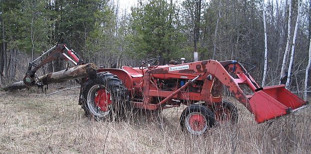

Here's a pic of the loader showing the bucket I made and the hydraulic bucket cylinder. I built the backhoe on the back as well.

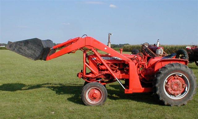

I'll look for pics of a Freeman 4000 too. Maybe it's something like this one that I downloaded sometime ago (and had forgotten about)?
thanks again for the insight.
