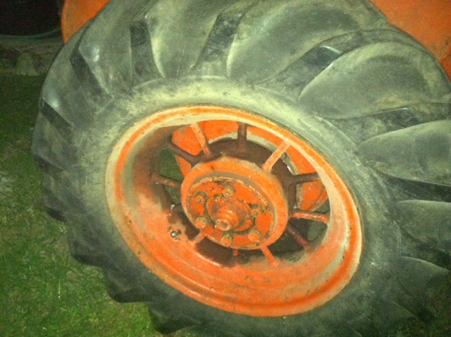

Post Options Post Options   Thanks (0) Thanks(0)   Quote dlong83 Quote  Post ReplyReply Direct Link To This Post Posted: 22 Aug 2012 at 8:52pm
are these original wheels for the tractor ive seen alot of pictures but none with these wheels?
Post Options Post Options   Thanks (0) Thanks(0)   Quote CTuckerNWIL Quote  Post ReplyReply Direct Link To This Post Posted: 22 Aug 2012 at 8:57pm
No, the styled WC's had a cast center with rim clamped on. The 24 inch spoked wheels would be from like 1936 or earlier. Not sure when they changed to the stamped steel 24 in rim.
This would be the original wheel set-up for a styled WC.

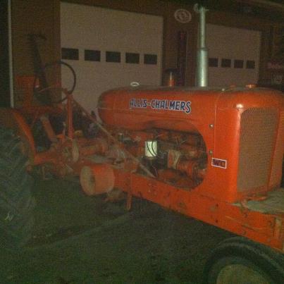

Post Options Post Options   Thanks (0) Thanks(0)   Quote dlong83 Quote  Post ReplyReply Direct Link To This Post Posted: 22 Aug 2012 at 9:01pm
ok makes sense now. on top of the transmission there is some sort of box with a wheel off the side with two spring loaded arms on it and there is a pedal to engage and dis-engage it as well as a lever can ayone tell me what this is/ looks like some type of centrifugal clutch
Post Options Post Options   Thanks (0) Thanks(0)   Quote CTuckerNWIL Quote  Post ReplyReply Direct Link To This Post Posted: 22 Aug 2012 at 9:16pm
That is the cultivator mechanical lift powered of the back of the tranny. Most that had that also had a disconnect for the differential so you can raise the cultivator without moving you wheels. The lift only turns if the tranny is in gear and the clutch is engaged. So , if you drop the cultivator and don't have the disconnect, you have to actually turn the back wheels to get the lift to operate.

Post Options Post Options   Thanks (0) Thanks(0)   Quote Kip-Utah Quote  Post ReplyReply Direct Link To This Post Posted: 23 Aug 2012 at 10:57am
The last unstyled WCs had 24" pressed steel wheels, as did the first styled ones from 1938 & 1939. Your spoke wheels are the same size as the pressed steel ones but from an earlier unstyled WC. After late 39 or early 40 WCs changed to the two-piece cast center wheels and went to 28" tires.Kip
