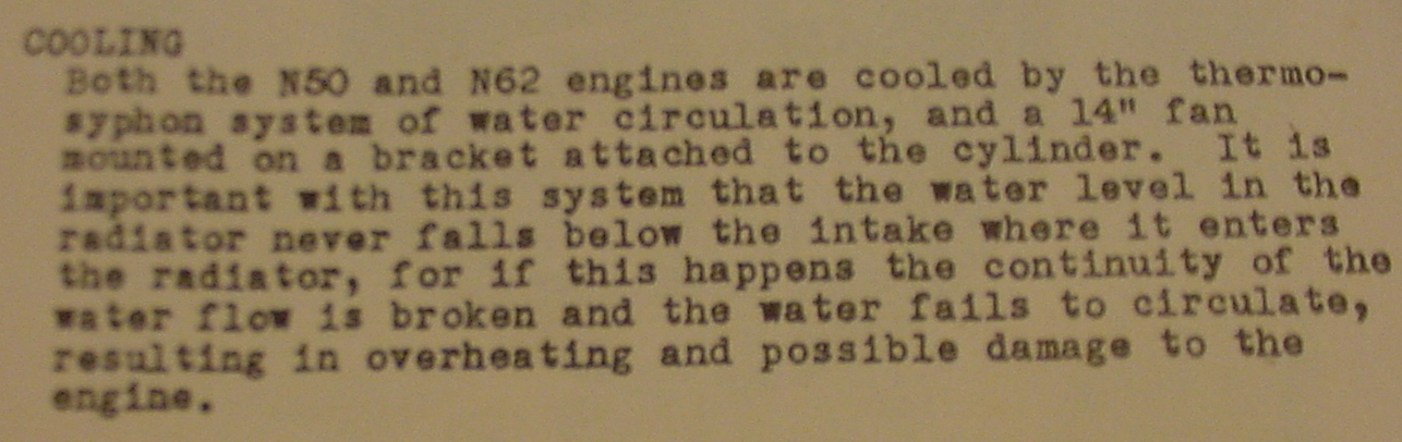

Top paragraph covers it well, I try to keep mine in the middle of the inlet or higher

We fill ours to the top of the radiator fill. If you don't keep it filled the water will not circulate and engine will overheat. If the radiator is full and it still overheats (assuming fan is working) then the system needs to be flushed.

All that the Continental N62 Instruction Manual has to say about the cooling system.
Gerald J.
