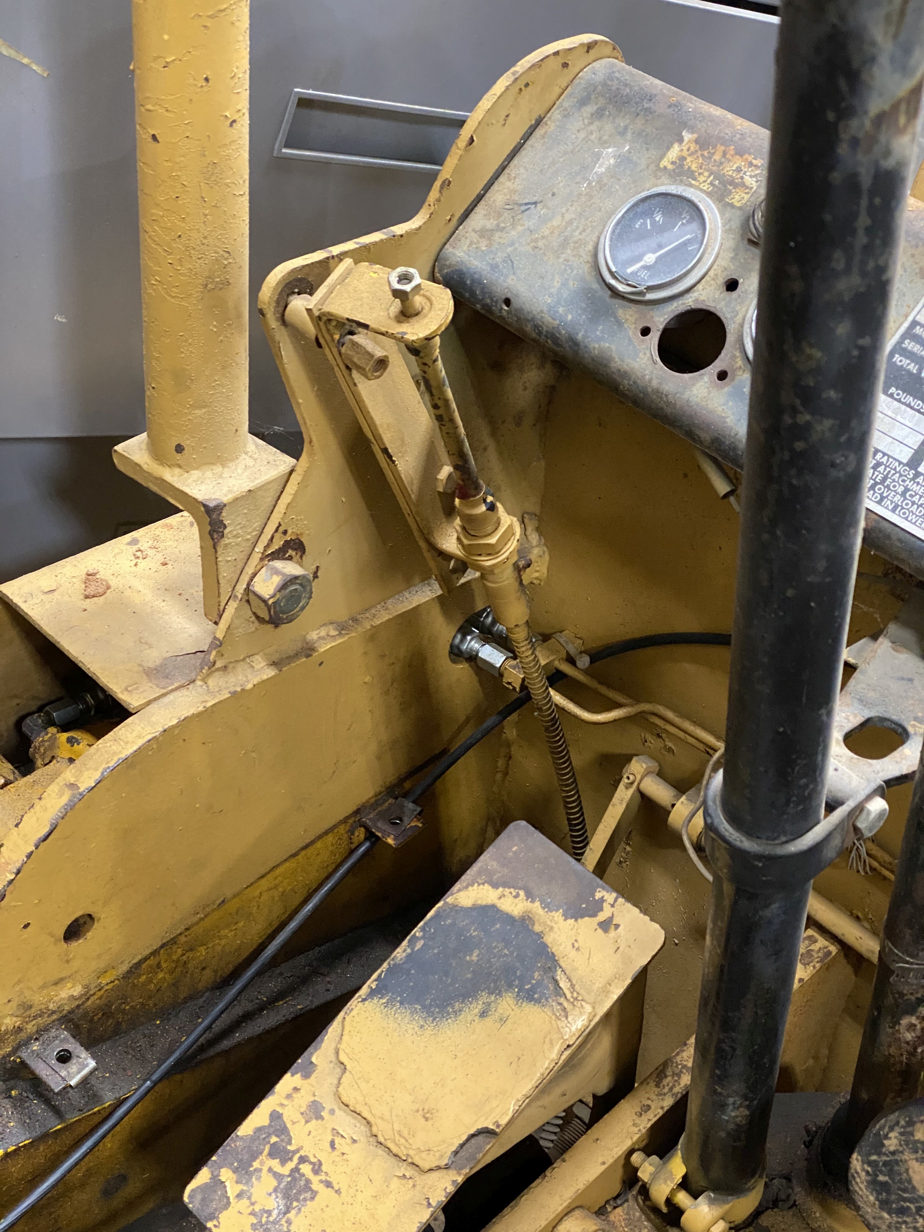

OK, hoping to reopen this thread..
I'd like to know how to put the '2 speed' control BACK onto the dash or wherever it's supposed to be.
Mine has a 'custom' lever on the floorboard, leftside, behind the heel of my boot.
Up seems to be low, down = high.
A picture would be nice....Google hasn't been to helpful, sigh....

Post Options Post Options   Thanks (0) Thanks(0)   Quote sinklar Quote  Post ReplyReply Direct Link To This Post Posted: 30 Sep 2020 at 9:46am
I don't think mine has the 2 speed option. I will try to find my manual over the next couple of days and see if it has a drawing.

Post Options Post Options   Thanks (0) Thanks(0)   Quote jaybmiller Quote  Post ReplyReply Direct Link To This Post Posted: 04 Oct 2020 at 5:25am
Thanks.. I've asked Google, several ways, but can't find a picture, cept one that kinda shows a knob on stick,near the parking brake, left of the 'inching' pedal.
I may create another 'winter project' and try to figure out how to make it. Right now my left heel hits the 'lever' down and into high gear.
meantime I might just put into low and disconnect , under the footboard access panel.

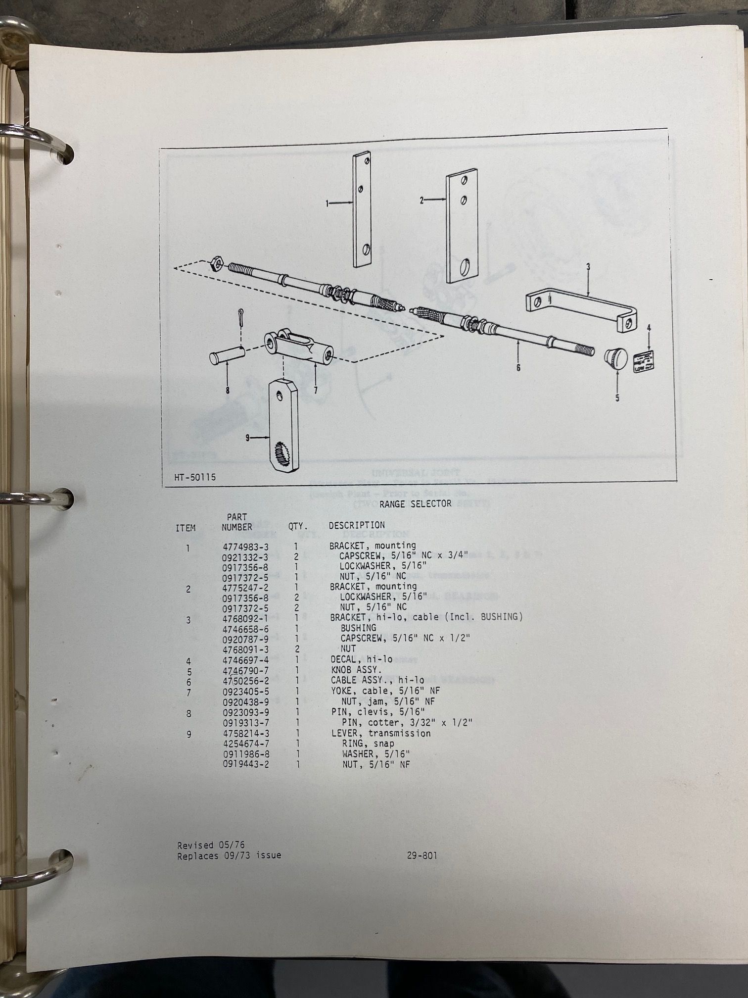

Post Options Post Options   Thanks (0) Thanks(0)   Quote sinklar Quote  Post ReplyReply Direct Link To This Post Posted: 05 Oct 2020 at 10:21am
Here is a picture from my forklift, it show the cable by the steering wheel. Also I have a picture from the parts manual I have included. If you by chance find a suitable cable I would be interested because mine is froze up.

Post Options Post Options   Thanks (0) Thanks(0)   Quote sinklar Quote  Post ReplyReply Direct Link To This Post Posted: 05 Oct 2020 at 10:27am
The other picture

you can have a cable made

Post Options Post Options   Thanks (0) Thanks(0)   Quote jaybmiller Quote  Post ReplyReply Direct Link To This Post Posted: 06 Oct 2020 at 2:04pm
hmmm... your hi-lo cable is where my parking brake is attached ! Makes sense about a cable instead of 'bars of steel'....
as a 'bodge', I've disconnected the PO bodge, stuck it in LO and real happy I can get up my driveway now  without taking a friggin run from acorr the road !!!
I should make it a real 'Winter project' though....
Thanks
