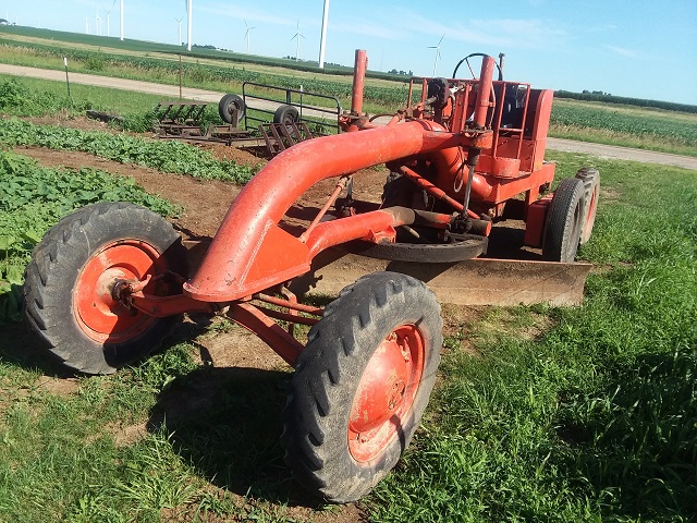

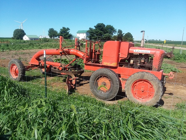

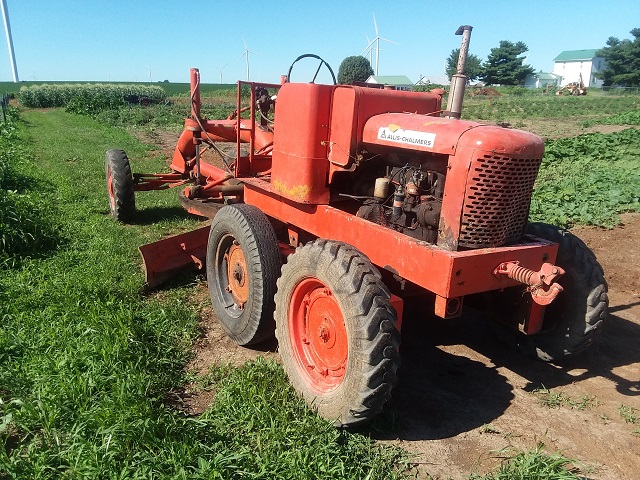

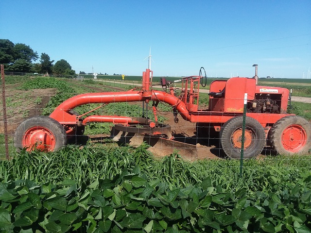

Got it home!---I drove that sucker the 7 or 8 miles!
Pix. as promised.
It has some oil leaks and needs the right blade cylinder re-built. --creeps down kinda fast.--someone put the ps unit on it and only ran it with an auto pump/res. and it don't work.--I will have to tie it in with the big pump to get enough flow .
First gear and reverse are WAY too fast, but that's what it has and I am using it! Does a good job.---NOT a 45, but it will do! LOL!!! thanks; ac fleet

A couple of things that I noticed. Your rear tires do not all match. There is no rear end differential and the front and rear wheels on the chain boxes are locked together so the four wheels will be continually fighting each other leading to wear and tear on the tires and drive train without matching tires particularly if it will be driven on pavement.  I adapted power steering to the D grader that I use to own and used an automotive power steering pump. My system worked so well that I could turn it lock to lock with one finger with the grader stationary and the engine just idling. It had a small,hydraulic cylinder between the the tie rod and front axle and a control valve on the drag link from the steering box.

   It appears that your grader may have had a scarifier on it. Did you get the missing pieces for it?
   I have a 1967 'D Special'. It also has hyd. brakes.

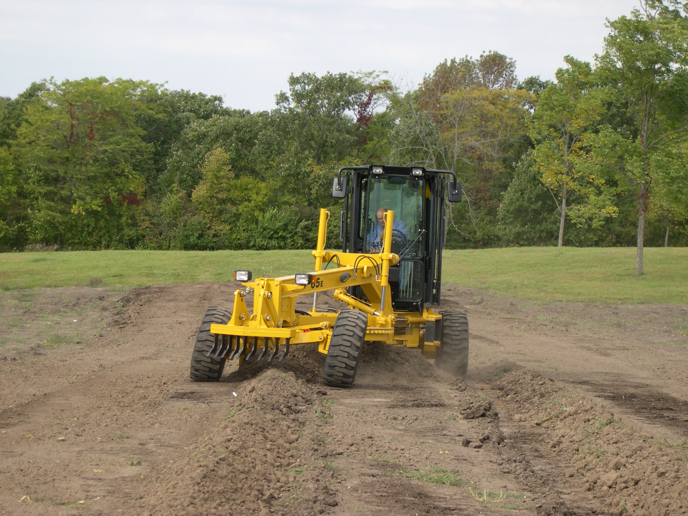

Ross D. View Drop Down
Joined: 02 Sep 2013
Location: Erin, Ont.
Points: 339
Post Options Post Options   Thanks (0) Thanks(0)   Quote Ross D. Quote  Post ReplyReply Direct Link To This Post Posted: 11 Jul 2018 at 6:09pm
   Hi again.
   Not to hijack this issue: but, these seem to be such a great machine.

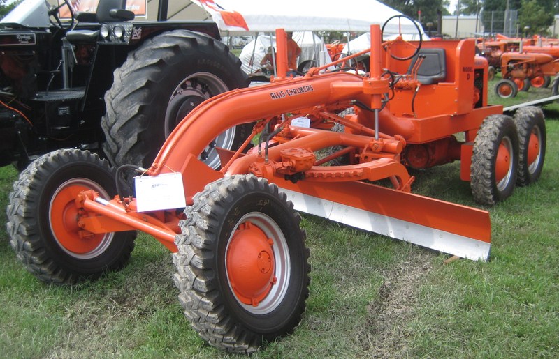

   On the last construction site, before I retired, the subcontractor did all the final grading with a Fiat Allis, open station, which he had just imported from Florida.
   A nice restoration:

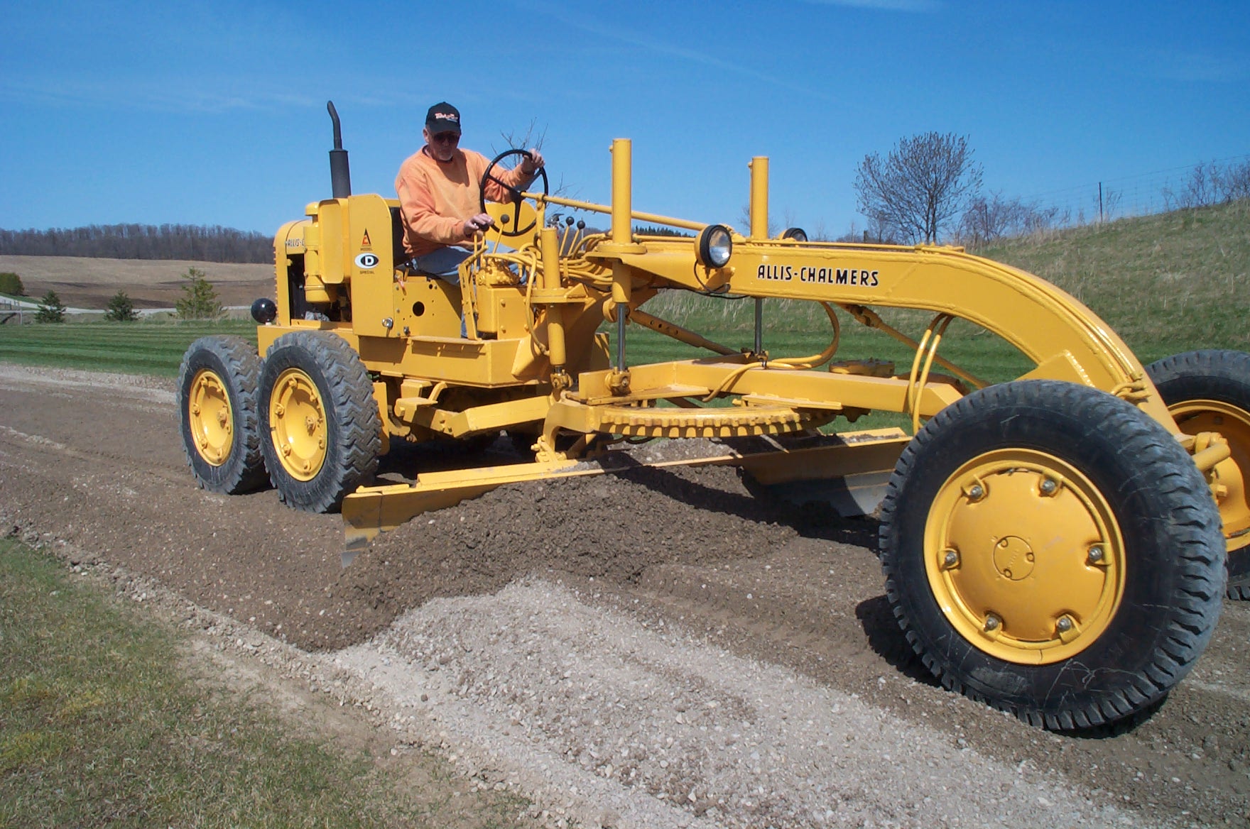

Post Options Post Options   Thanks (0) Thanks(0)   Quote ac fleet Quote  Post ReplyReply Direct Link To This Post Posted: 11 Jul 2018 at 10:17pm
Bottom pik. has wheel lean,--mine don't!--- would have look at the motor to see about the side pan. thanks; ac fleet

It does have the side plate on this engine. thanks; ac fleet
