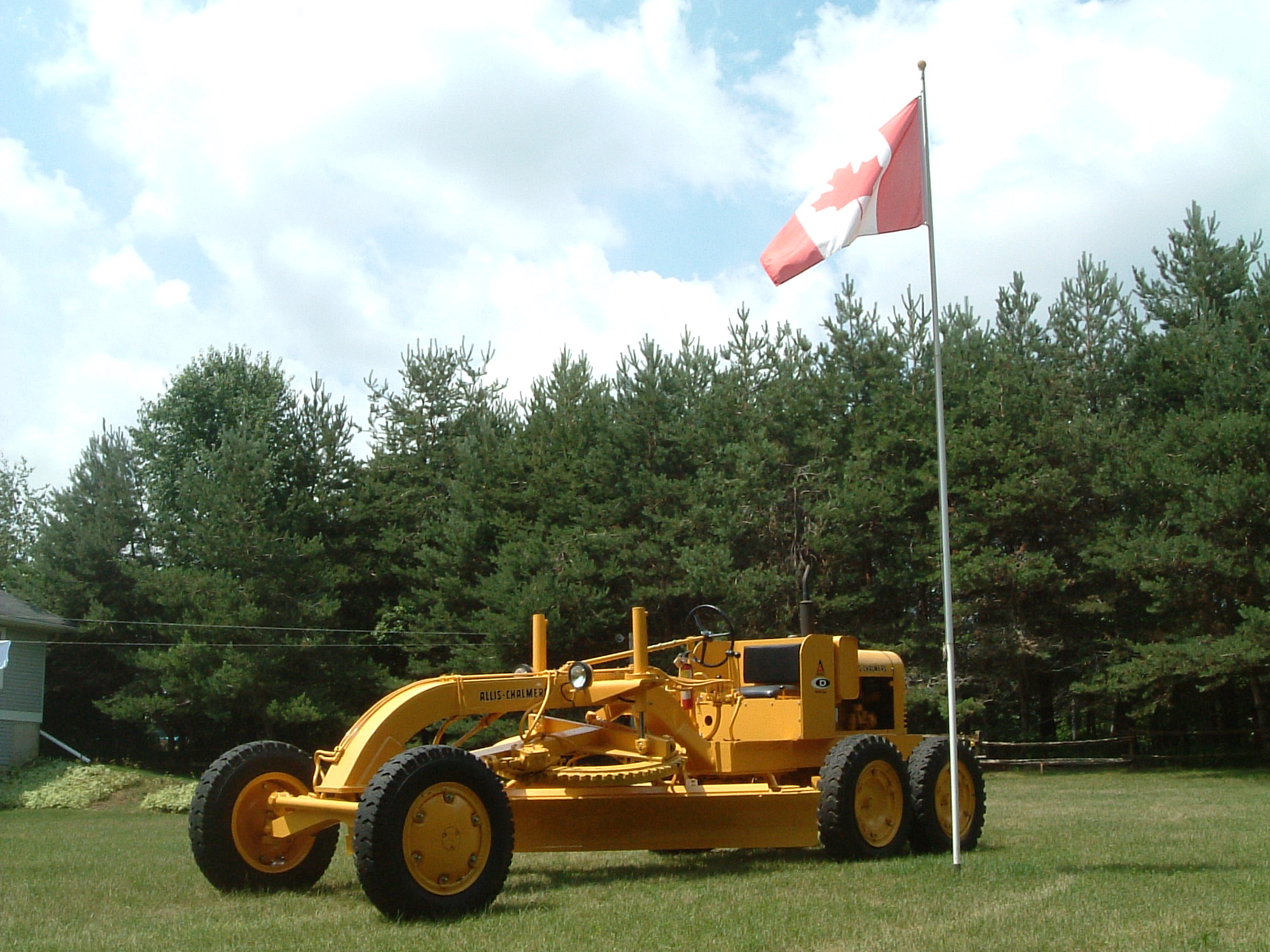

Hi. It appears that A. C. introduced the D17 engine into the D series grader in 1958. No doubt, a lot of engines were swapped in and out as required. I had a 1967 'D. Special'. Great machine.     Ross D.

Post Options Post Options   Thanks (0) Thanks(0)   Quote Ross D. Quote  Post ReplyReply Direct Link To This Post Posted: 02 Jan 2023 at 8:12pm
   Hi again.    Sorry about the picture size.   I do not have my information books here. We are currently on vacation in Florida. We will be back 'to the Shop' by mid April.
