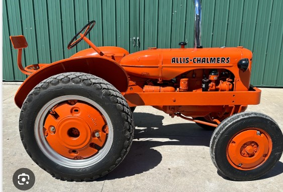

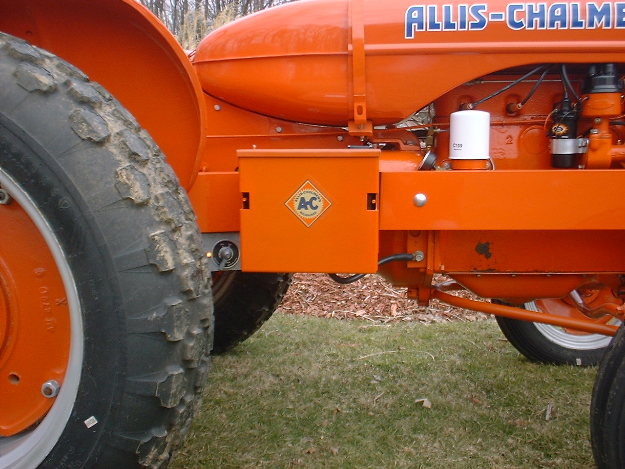

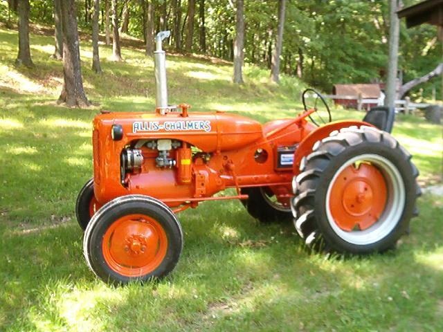

As mentioned , the IB had a shorter torque tube and steering column and therefore did not have room in front of the shift lever for the battery. The battery was moved to another area, normally by the fender..
  ORCHARD means "lowered" to go under the trees.. No factory units were OB... but many people have modified the B to make a generic "OB"... This would be obvious by looking at the location of the battery box, still in front of the shift lever, and probably retains the original "B" fenders , and would not have the C channel frame as it would be 6 inches too short ( short torque tube on the IB).... I built at OB 15 years ago by rotating the rear housings 90 degrees forward and building a straight axle similar to the IB unit....NOTE ... some modification needs to be done to the spindle upper arms as I remember to get the steering rod / etc aligned.

Post Options Post Options   Thanks (0) Thanks(0)   Quote steve(ill) Quote  Post ReplyReply Direct Link To This Post Posted: 10 Jul 2019 at 2:53pm

Post Options Post Options   Thanks (0) Thanks(0)   Quote steve(ill) Quote  Post ReplyReply Direct Link To This Post Posted: 10 Jul 2019 at 3:01pm
Notice the IB is shorter torque tube and no room for the battery box.... and an IB would have a C channel frame ( after the war), and WD45 type fenders.

Post Options Post Options   Thanks (0) Thanks(0)   Quote fleeter allis fan Quote  Post ReplyReply Direct Link To This Post Posted: 10 Jul 2019 at 7:04pm
Steve, your photos look a lot like the examples that I have seen. The torque tube length and battery location seems to be the key to determining if it is an IB or a lowered modified B. Thanks. Rusty.
