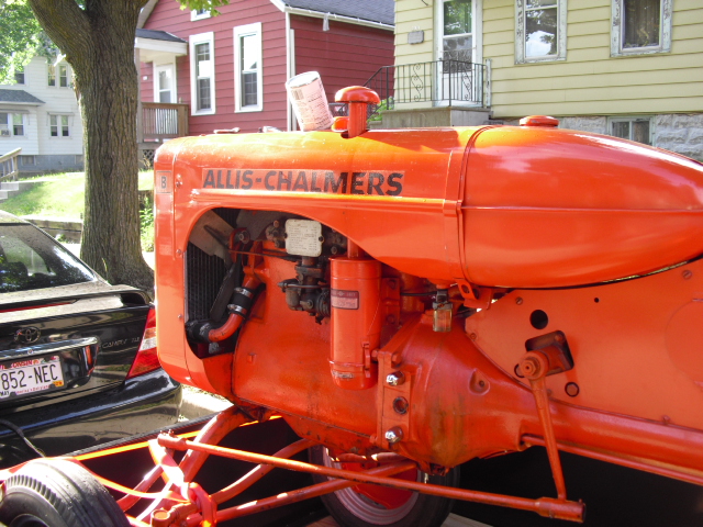

I will get better pictures later I am taking it to work to show off. I will also figure out posting pictures better.
