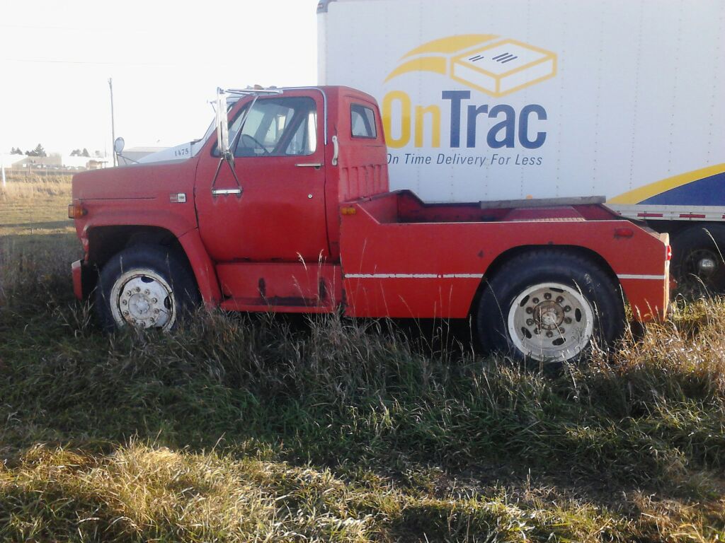

It's a $1000 truck, not a show truck. Just want it all one color after I get the dents and rust fixed.

If that was my truck I would go with
single stage PPG Omni Acrylic Urethane  in the ac orange that matches your tractors. No mistake about it . Any auto motive paint will outlast and outshine any cheap enamel money can buy.  Over the red on the truck now PPG single stage orange should go a long ways. Spot Prime any body work close to the sanded original color. Sand it all with 320.  Take a chance to save a buck by not prepping to finish paint with a full coat of sealer first.
 I primed a whole B with plain old orange enamel and finished with PPG Omni after several days of drying to sand the enamel very smooth and give it some tooth. One of the best PO#1 Bs to leave the paint booth ever.   My CA puller got the same kind of paint job in 2002. Still looks fresh and very nice 16 years later
