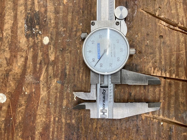

Ok i’m pretty sure those two small terminals are not hooked to anything just as Jay said. It will not excite wide open rpm’s so I’m going to post a picture of the pulley that I am using I don’t know if I can get a smaller one can I?? And I imagine it is metric as is the mounting hole and tension hole.

the "STANDARD" alternator pulley  is 2.7 inch diameter and 17 mm ( .669 inch) hole... They do make 2 inch diameter pulleys ( some vendors)... you may want to VERIFY the hole size.
some of the smaller alternators are 15 mm .. (.591 inch)

I am surprised that the alternator will not AUTO EXCITE at full engine throttle... Is is possible the alternator is BAD ?  Is it new ?  What size pulley is on the crank shaft... divide that by 2.7 inch and multiply by HIGH RPM to get the alternator RPM.
15 mm HOLE pulleys are not that common.. You may have to turn that one down on the lathe, or get a 2 inch dia  -  1/2 inch hole pulley and have it reamed out to .591 "   ....... but i would verify the alternator is good first... but hard to do  if it will no Excite.... a "TEST" might be to switch alternators with another tractor.

Most of the mini Denso mainshafts are 15mm. If you wire the Alternator as a three wire, you don't have to worry about smaller pulleys and what not. It's two more wires you have to run. The IGN wire runs to the key switch ignition source, so when you turn the key in the ON position, you send 12 volts to the VR to turn it on. The "L" is the voltage sense circuit you can run to the Battery side of the Starter solenoid, or Starter motor itself. Run that parallell with the Alternator's output wire and connect them together at the Starter or Battery circuit. The voltage sense circuit will monitor current usage at the Starter. It will also keep the Battery "full". One thing people don't take into consideration with these one wire systems, is the voltage drop from the Alternator to the Starter motor or Battery circuit. Sometimes it could be up to a volt. Doesn't sound like much, but it you don't have the voltage sense circuit hooked up to monitor and current flow in the system, it can't send a signal to the Alternator to ramp up and "balance" the voltage in the whole system to 14.2 volts. Without the sense circuit, if you turn on the Headlights, worklamp, or you may have a sprayer hooked up to the Tractor, ignition system needs full power, with no sense circuit, your suckin' off the Battery and the Battery may not have enough reserve to sustain the draw on the system between the voltage drop, and the draw. You may have to put a 1 amp/50V diode in the IG circuit to eliminate run-on when the key is off.  Three wire. Three wire. That's the way to fly on a Tractor. No revvin' the crap outta' the engine to start the charging, no little pulleys, no low current in the system, no burnt points, or E.I. and no low Battery issues.
