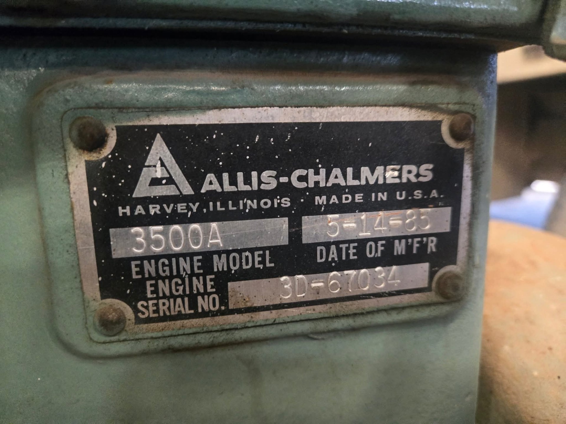

if the engine conversation is about the unit Lad/orange knight had listed, this should be the engine tag.. Would not that tag be toward the end of the series? Thanks...Dale
Yes, the engine is the one in the classified here listed by Lad.
Besides the factory style tag on the rear LH corner of the block, the picture also shows another tag farther forward on the LH side........maybe this tag has some rebuild SN or component information. If it is that late of production engine, would it likely have piston cooling jets in it?
Thanks for your help!
Lad sent me a picture of the tag and as you stated, it is the same date of MFR and the same engine SN as your picture above. Is the date of MFG and the engine SN the original one from Allis when the engine was built? I would think it would be.
Anyone know what the A suffix means in the model number?
The other tag shows the rod and mains as being .010 & .010 and overhauled at OSMS, OREGON

Post Options Post Options   Thanks (0) Thanks(0)   Quote DrAllis Quote  Post ReplyReply Direct Link To This Post Posted: 2 hours 27 minutes ago at 9:56pm
The suffix "A" would mean it is a first generation 3000 series engine. This would mean the oil filters are positioned to run oil down the side of the block when you remove them and if equipped with an oil cooler (turbo'd engines) it is vertical in location right behind the injection pump. Typically, we would see them in D-21, 210 and 220 farm tractors.  I don't think piston cooling jets would be there as the cam driven style oil pump didn't have enough GPM's for that feature, or maybe they blocked the jets with the blank main bearing shells? . The crankshaft driven pump was the same as a 7030/7050 tractor which the 7050 has piston cooling.
