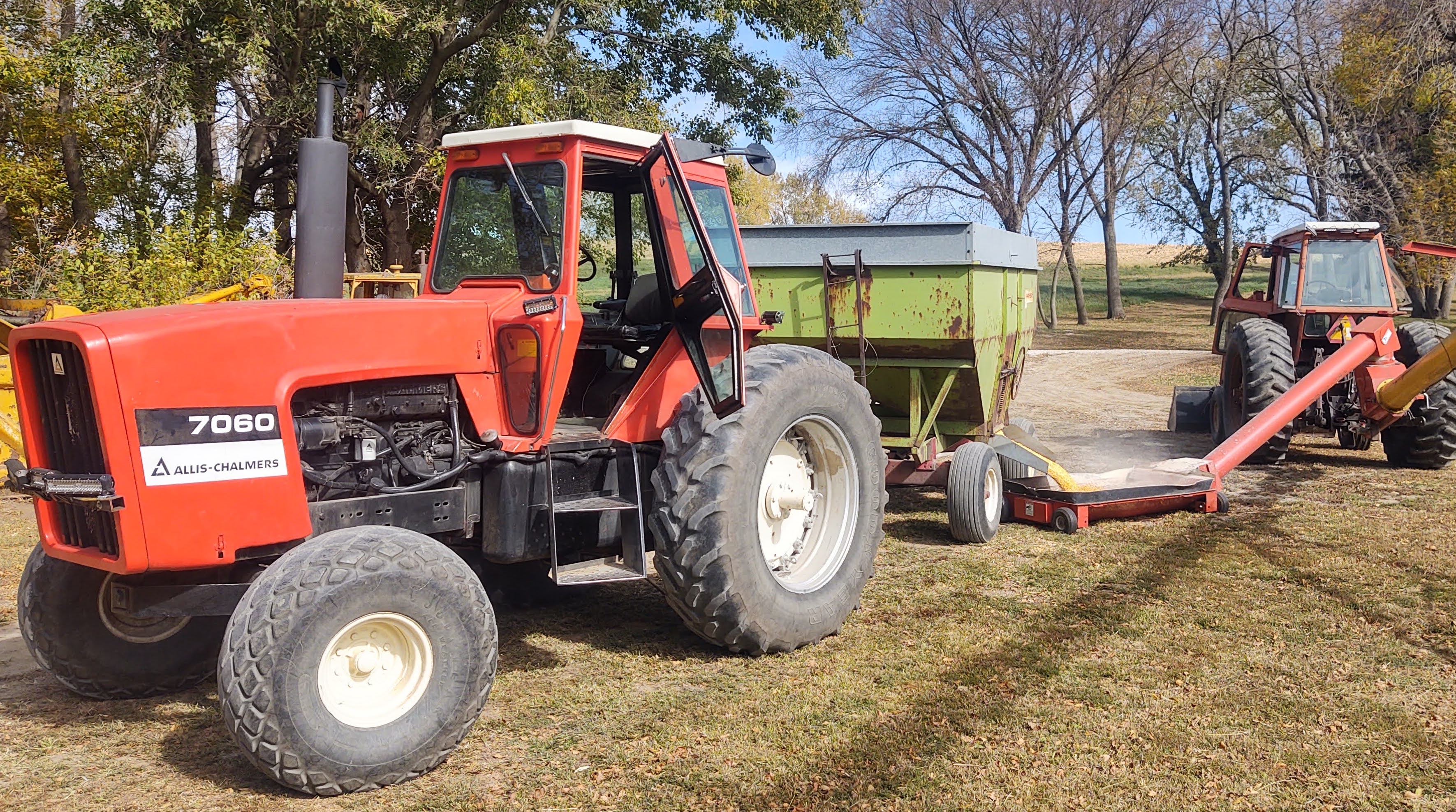

That's a sharp looking 7060. Did you wax and buff it?  Dr. Allis and Mack have a whole lot of knowledge!

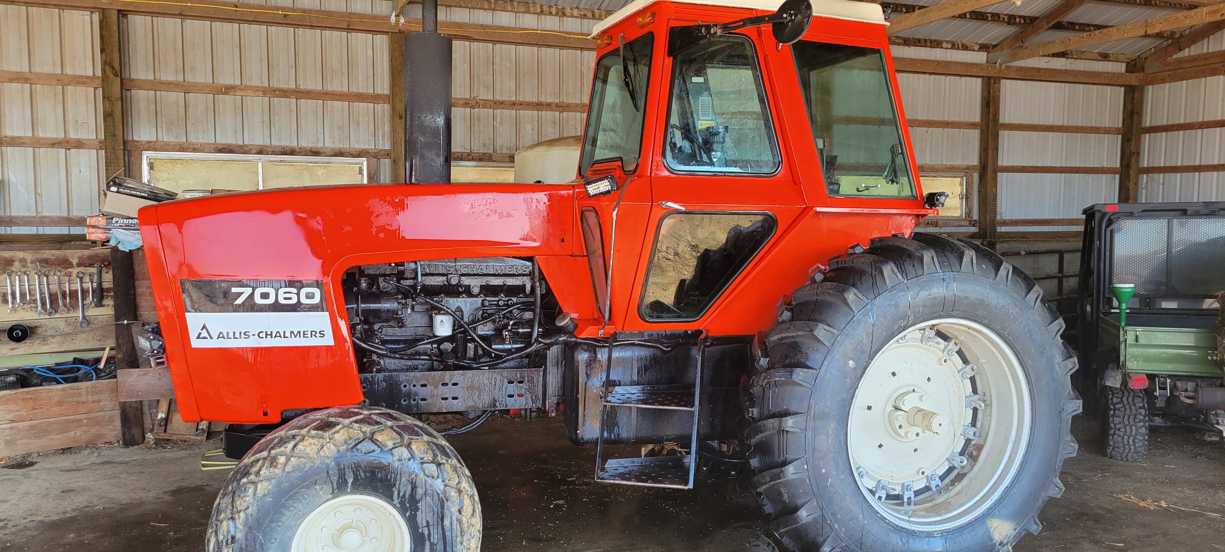

Other than washing it often, it came looking that awesome when I bought it last September. The guy before me took real good care of it.
The interior also looks just a good. For my first tractor that I bought, I sure am happy with it, even though the tranny didn't last long.
