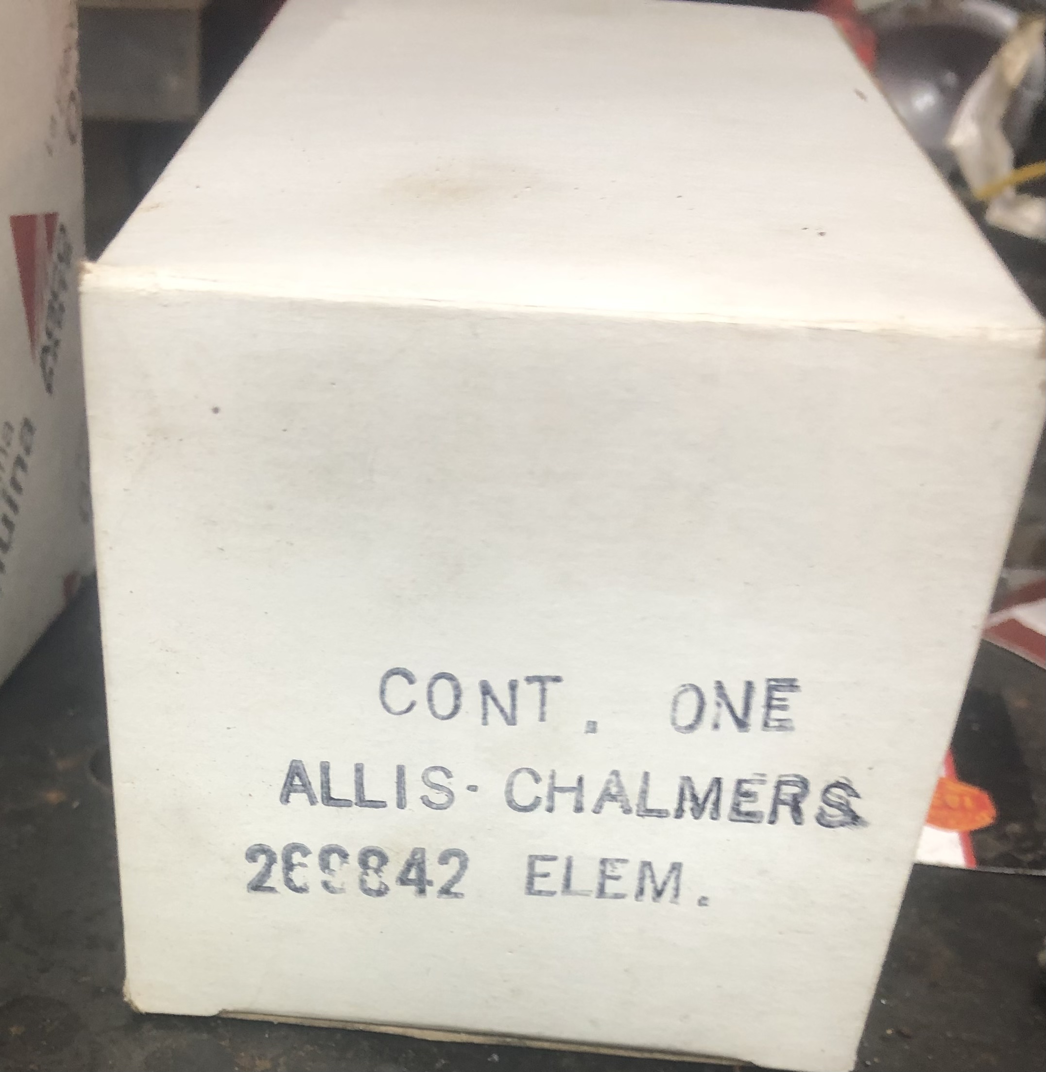

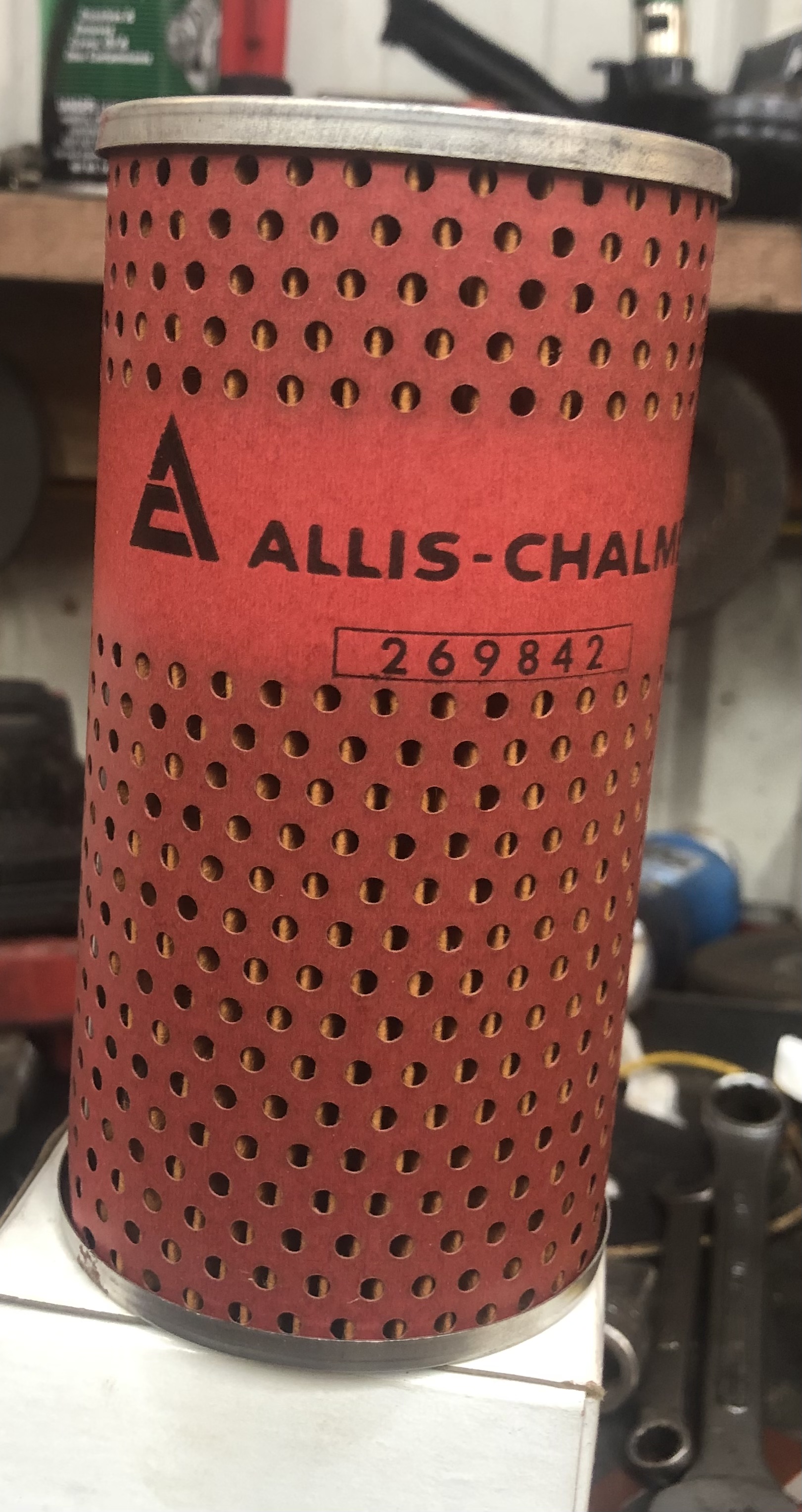

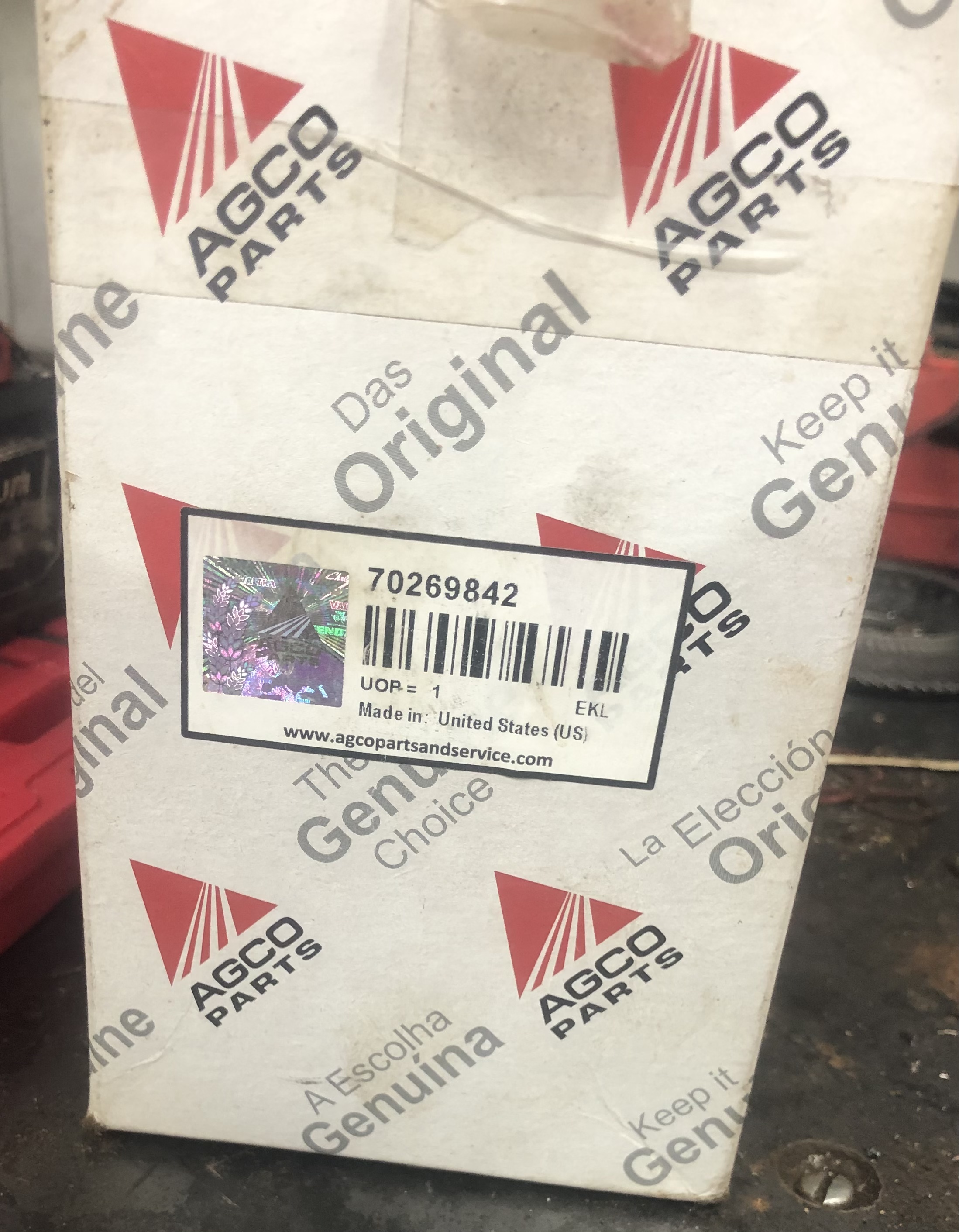

Well it appears that agco has finally sold out of there stock of allis-Chalmers 269842 or Agco 70269842 powershift filters and it’s NLA, I still have one saved back, now the element for the updated black bellys powershifts is still available through agco, my question is would it be wise to convert my 76 7060 powershift over to the newer filter/housing and everything that takes or would it be just as well to run a 51420 wix/Napa gold in it which is still available?
