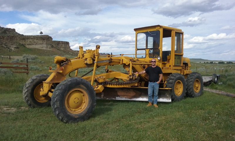

Thank you for the compliment... she's pretty solid, just needs a little work.

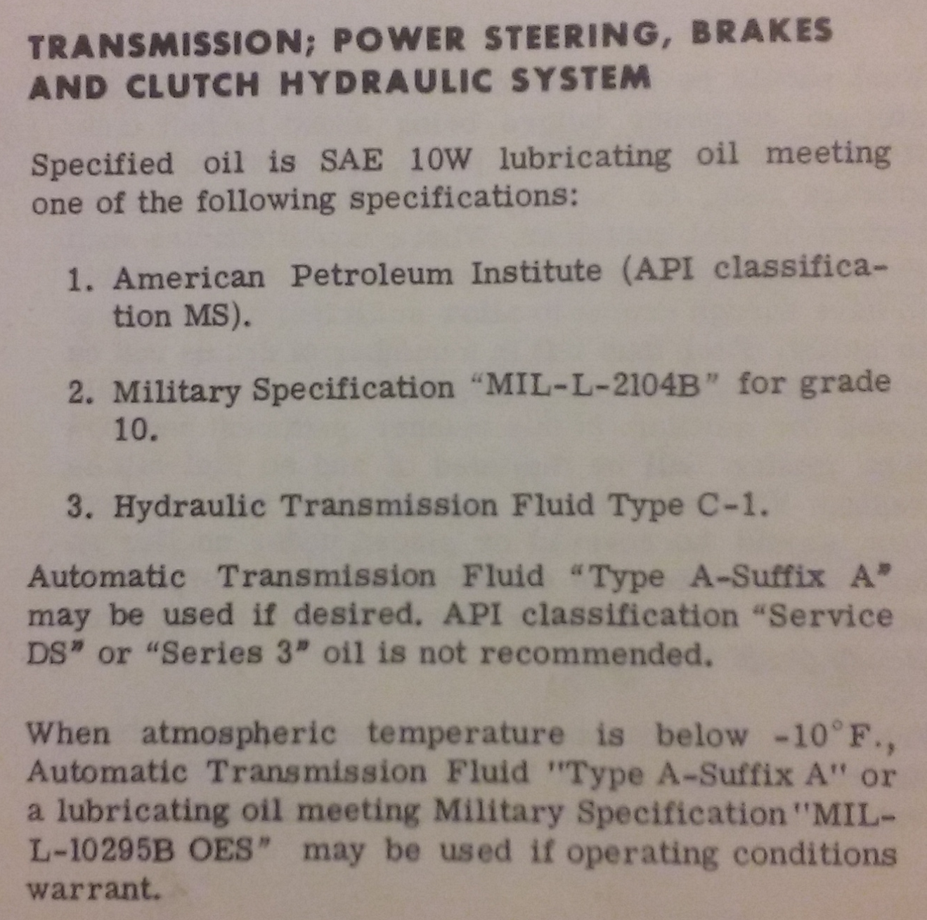

I found the operator manual for it and took a photo of what it recommends for hydraulic oil, but it seems very vague to me...  Is it just saying regular 10w oil is good enough, or is there something I'm missing?
