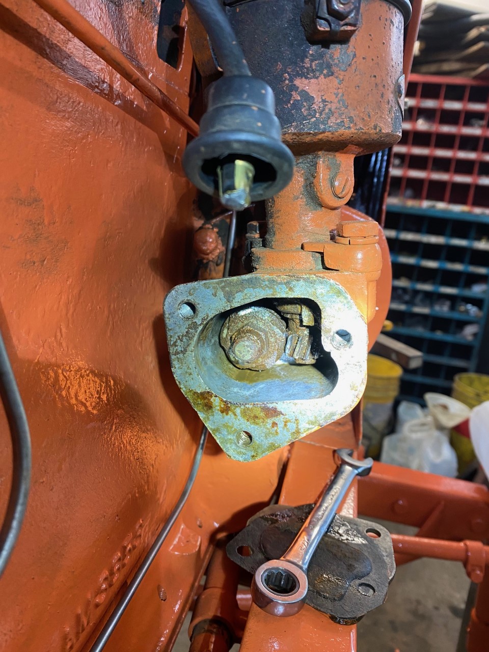

Hello all , my restauration go well , and i just look at the pinion and gear for the distributor , the oil inside was slushy , have you idea where the lubrification came from ?
thanks in advance

Bonjour Ami- Pas certain, mais je crois que le pétrole vient des trains avant. Si c'est le cas, soupçonnez que le passage est bloqué. Ces engrenages ne devraient pas avoir l'air si secs.
Guys- correct me if I'm wrong- isn't the lubrication for distributor gear supposed to drip in from some passageway up by the front gears?
Edited by DaveKamp - 05 Jan 2023 at 5:19pm
Points: 90101
Post Options Post Options   Thanks (0) Thanks(0)   Quote steve(ill) Quote  Post ReplyReply Direct Link To This Post Posted: 05 Jan 2023 at 5:53pm
i dont think lube comes from the motor.. I think there is a plug on the backside of the distributor that you can add to..
I would be temped put a plug in that 3 bolt cover, and fill it from there.
seems like there was a post a few years back where someone filled cavity with grease ?
Edited by steve(ill) - 05 Jan 2023 at 5:55pm

Wow! That looks like the Sahara Desert in there!  And by the looks of the wear on that Distributor drive gear, that's been dry for quite some time. Fill that cavity with EP Moly grease and cap it up. Hopefully, the drive gears will stick around for a while. Those particular drive assy's have a hole right above the long Distributor drive shaft. When you dump motor oil in though the drive housing to fill the crankcase, some oil goes in that hole as well to lube that long shaft. There is a hollow tube that runs down the side of that drive, but hardly any oil goes down that tube to get oil to the drive gears. Best to put some EP Moly grease in there like I suggested. Wash it out first with a little Brakekleen first and get the baby poop outta' there.

Steve,what's with the 1/8 slotted plug on the vertical?
Points: 12069
Post Options Post Options   Thanks (0) Thanks(0)   Quote Steve in NJ Quote  Post ReplyReply Direct Link To This Post Posted: 06 Jan 2023 at 11:04am
Steve,
That's an oil galley for lubrication to the Oilite mainshaft bushing. When Delco made the Distributor, after the mainshaft bushing is pressed into position they then fill the oil galley with machine oil and cap it off with the 1/8" NPT plug. Oilite bushings are already impregnated with oil (hence the name)  As the mainshaft spins and generates heat, the machine oil is absorbed into the oilite bushing to keep the mainshaft lubricated as well as the bushing. An optional thing when servicing those mainshafts is install a zerk fitting and pump grease into the cavity. Not much, just a pump or two, and you're good for a couple years. What the grease does is push the machine oil around the Oil lite bushing once again and keeps the bushing lubed. That machine oil stays in there for years n' years. Just about every Delco Distributor I rebuild, when I press the mainshaft bushing out, that machine oil runs right out the bottom. After rebuilding the Distributors, I do the same thing Delco did. Fill the oil galley with machine oil and cap it off... HTH
Steve@B&B
Points: 8896
Post Options Post Options   Thanks (0) Thanks(0)   Quote SteveM C/IL Quote  Post ReplyReply Direct Link To This Post Posted: 06 Jan 2023 at 12:17pm
The reason I ask is because a few years ago I pulled the plug loose on dad's 49 WD he bought new and there was some redish colored juice try to escape so I just tightened it back up. I certain it has never been apart and wondered why the plug as I've never heard it addressed before.

I used to sell the gear by itself, but as time progresses, they're getting tough to get and I keep the ones I have for the Distributors that come in to get rebuilt. Grab a hold of the rotor and see if the rotor moves side to side .002-.003". If it does, the mainshaft bushing is worn and the Distributor will need a rebuild. If it doesn't move you're good ta' go. When the mainshaft bushing wears, it allows the mainshaft to wobble. That wobble changes the dwell on the points which in turn the engine eventually starts to run lousy as the rub block on the contact set wears crooked. It also puts unwanted wear on the drive gear.... HTH

That cavity gets grease put in it. When you dump oil in through the filler cap, most runs down to the oil pan. There is a little bit that goes in the hole to the main driveshaft, but not much gets down front to the Distributor. Clean the old muck out it (if it has some) and then Fill it with EP moly grease.
