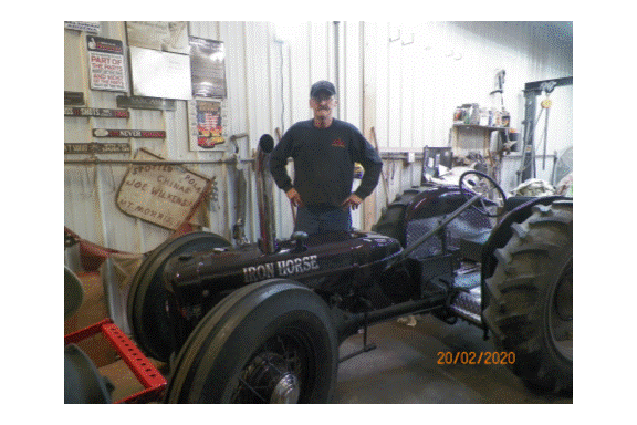

This is my lowrider. did 180 and redesigned the brake mechanisms. Flipped the brake bands around.

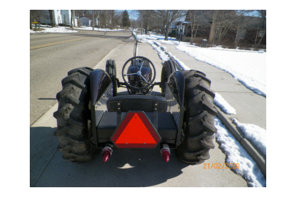

Post Options Post Options   Thanks (0) Thanks(0)   Quote Steve Wilkens Quote  Post ReplyReply Direct Link To This Post Posted: 29 Feb 2020 at 6:16am
another view

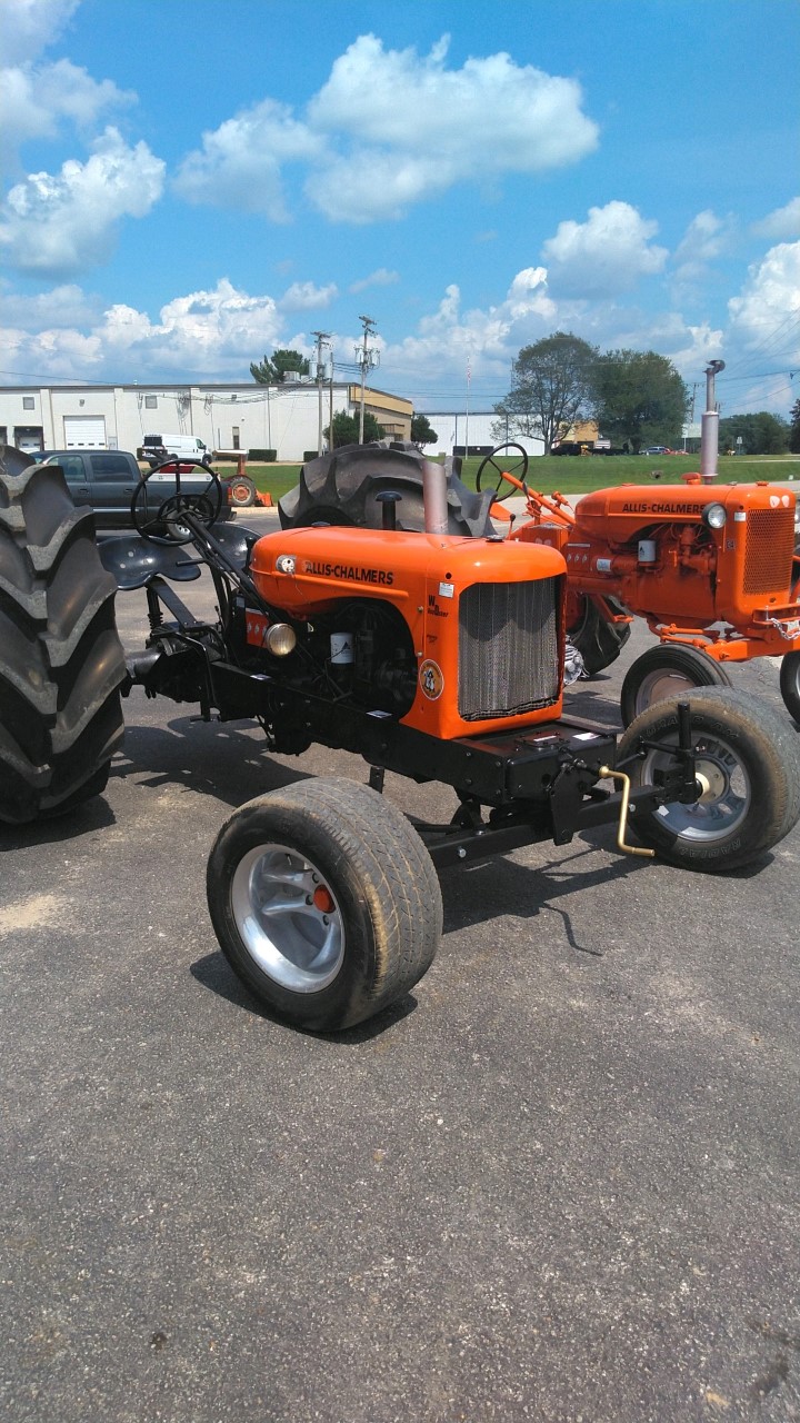

Post Options Post Options   Thanks (0) Thanks(0)   Quote tbran Quote  Post ReplyReply Direct Link To This Post Posted: 29 Feb 2020 at 12:44pm

Steve
What I’m the world are those front wheels and tires off of and what size are they?? It looks pretty darn cool what ever it is!!
Steve Wilkens View Drop Down
Location: Ceresco, Michig
Points: 447
Post Options Post Options   Thanks (0) Thanks(0)   Quote Steve Wilkens Quote  Post ReplyReply Direct Link To This Post Posted: 29 Feb 2020 at 1:19pm
1932 Ford 18" wire
