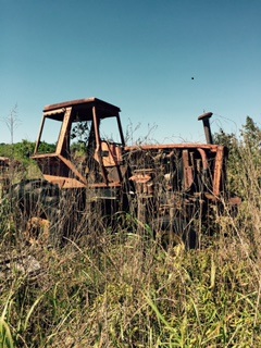

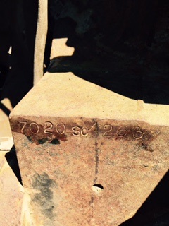

Another poor dead soldier. The exhaust is uncovered so the engine is probably locked up. I am wondering if I found a standard 7000 series doner how hard would it be to swap out the front axle and drop housings to build my own High Clearance. I actually have a need for one. I have also thought about finding a 190 HC and putting the hardware on my 200. Anyone have any advice?  Note the SC stamp on the serial number. I assume that stands for Suger Cane?

should be lots of good parts left on them
Points: 8391
Post Options Post Options   Thanks (0) Thanks(0)   Quote DougG Quote  Post ReplyReply Direct Link To This Post Posted: 03 May 2017 at 2:30pm
Dam that poor sucker is rough,,,, why why

porn?  looks more like a horror film!  that poor machine, hows come ya don't see celebrity adds on tv for poor neglected Allis's?

Yikes! WHAT HAPPENED TO THAT????
And to imagine that poor machine was brand new and top of the line at one point....jeez, what happened.... I never understand how people can tear stuff up...
