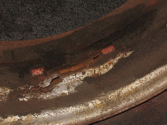

Are you for sure tightening these the correct way?  The eccentrics (2) have a cross on the front part of the bolt.  They are installed NEXT to each other and when tightened, the bottom part or long part of the cross is TOWARD the rim.  You shouldn't need more than 2 of these.
IF you DO, you've probably got the problem that I had.  The rim is rusting out.  This allows the eccentrics to PUSH into the rim eventually causing THIS to happen.
Luckily I had an extra hitch part on the rear that held the tractor up otherwise I'd of had a REAL mess.

Ted J - yes, I am sure I tightened them the right way. These rims are not rusty
