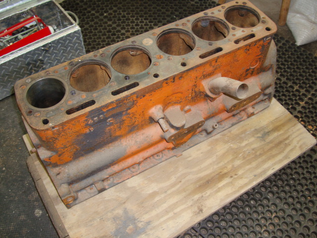

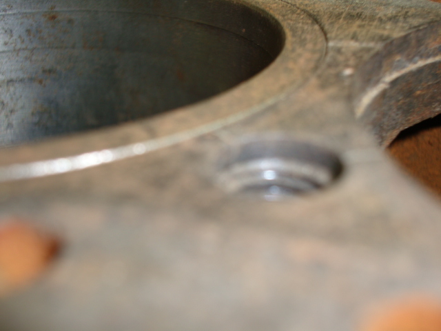

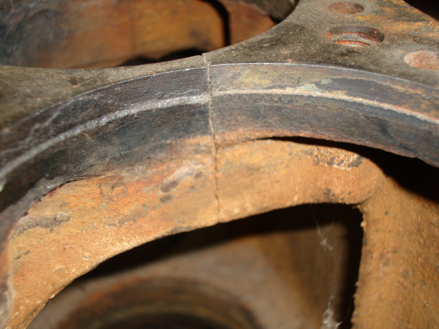

I have one also, will take second seat to Tony of course, I'm about to junk this block, it has crack on top of deck [ like they all do] tried selling many times and cant find a buyer, tired of looking at it.

chris...where exactly is the block cracked?if it between the cyl.webs and not gaped open,that is no big deal.any other cracks are major.i need one for one of my 45 diesels.if interested give me a call....903-930-1387...thx

chris...thx for the pix.of the block,if it was just hairline cracks between the sleeve web it would not be an issue for me.the one pix of the crack going into the water port and on in to the head stud boss,that is real trouble.yhere is a place in iowa(cant remember the name)told me he could repair the one of mine,but for parades only(no pulling,which i do,and no farm work.)...cris how many diesels do you have? ( wd45).i do want to thank you for the reply....j.w.freck

I still have some 45D parts, tractors all gone. I was hoping someone who is desperate would buy the block for core and have it furnace welded, and re-machined back to life. I do not need to scrap it yet, but by years end it will be gone.
