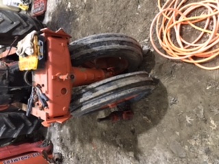

I’m located in Indiana. Looking to swap out the narrow for a wide front. Any tips on how to modify or what to look for to make sure it will bolt up. I hear there’s a 3 or 4 bolt pattern and that’s all I have so far.

So it looks like I would need to change the whole front end as this one is all one piece.

Loosen all the bolt s on the left frame ( as you are sitting on the seat) and spread the frame rails to remove the old narrow front. It's most likely been on there for more than 62 years. They don't come out very easily.

Be aware that the bolts in the bolster may twist off. If happens on removal no big deal if not reusing it. Check replacement for twisted off bolts before install. Get some new GR5's for install. The switch is rather easy if properly supported and loosening one rail up is good advice. They are a snug fit otherwise.
